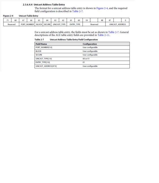

  • Itay,
    Can you send status of ALE registers of Ethernet Switch Sub-system? I have added those registers as "ALE_Status" menu in the attached GEL file.
    7532.cpsw_stats_print.gel
    Bhavin
  • Itay,
    We need to check status of above mentioned registers in your application. Your ALE configuration should be one of below two options. For both the options there is a way to send packets out from a defined port. So we will need to check whether your application is following those instructions or not. Here are two ways to send packets out from Port1 and Port2:
    1. Keep ALE in bypass mode ALE_BYPASS is enabled and PORT_STATE in the ALE_PORTCTLx is in forwarding mode.

    2. Configure ALE in non-bypass mode and PORT_STATE in the ALE_PORTCTLx is in forwarding mode. Then send unicast destination packets to each port:
      &host_wr($ALE_CONTROL ,0xc0000000);    #UnReset ALE and Flush Table
      &host_wr($ALE_PORTCTL0,0x00000003);    #Simple Port setup 0, etc
      &host_wr($ALE_PORTCTL1,0x00000003);    #Simple Port setup 1, etc
      &host_wr($ALE_PORTCTL2,0x00000003);    #Simple Port setup 2, etc
    Now add unicast MAC addresses in the ALE table as shown below:

    Here is the definition from user’s guide for adding unicast entry into lookup table:

  • Bhavin,
    At first the output of the GEL script on both DSPs was:
    GEL Output: CPSW ALE CONTROL ................ 0x80000000
    GEL Output: CPSW ALE PORT0 CONTROL ................ 0x00000003
    GEL Output: CPSW ALE PORT1 CONTROL ................ 0x00000003
    GEL Output: CPSW ALE PORT2 CONTROL ................ 0x00000003
    I then changed the nimu_eth function Init_Cpsw to set ALE CONTROL as you recommended, so the value shown by the script is 0x80000010. Other than that, this change has no effect on the results.
    An interesting point I've noticed is that when the two DSPs ping each other, I can see a single ARP request being broadcast from each of them, but no additional requests. From this I gather that the ARP negotiation is working. However, I could not confirm this as the NDK apparently has no API to query the dynamic ARP table.
    The rest of your message seems a bit daunting. It isn't clear whether your suggestions are solutions or tests, because as solutions they seem unacceptable (the switch is supposed to do this stuff automatically) and as tests they are a little beyond my level of knowledge. I am but a humble NDK user, not a low level network coder, my code doesn't set the protocol headers for packets sent out over the network. I don't know how to use a structure like "host_pkt" or "p0_pkt" - I use sendto() and recv() :) .
    What I have tried however is to use your suggestion from option 2 to manually force the ALE to route packets intended from DSP 1 to DSP 2, through DSP 1's port 2 and vice versa, then run the ping test. My modified version of the nimu_eth function Init_Cpsw is shown below, yet it seems to have no effect whatsoever on the results.
    If you think this test is wrong, please elaborate on how to do the low level packet tests as I really wouldn't know where to start on that.
