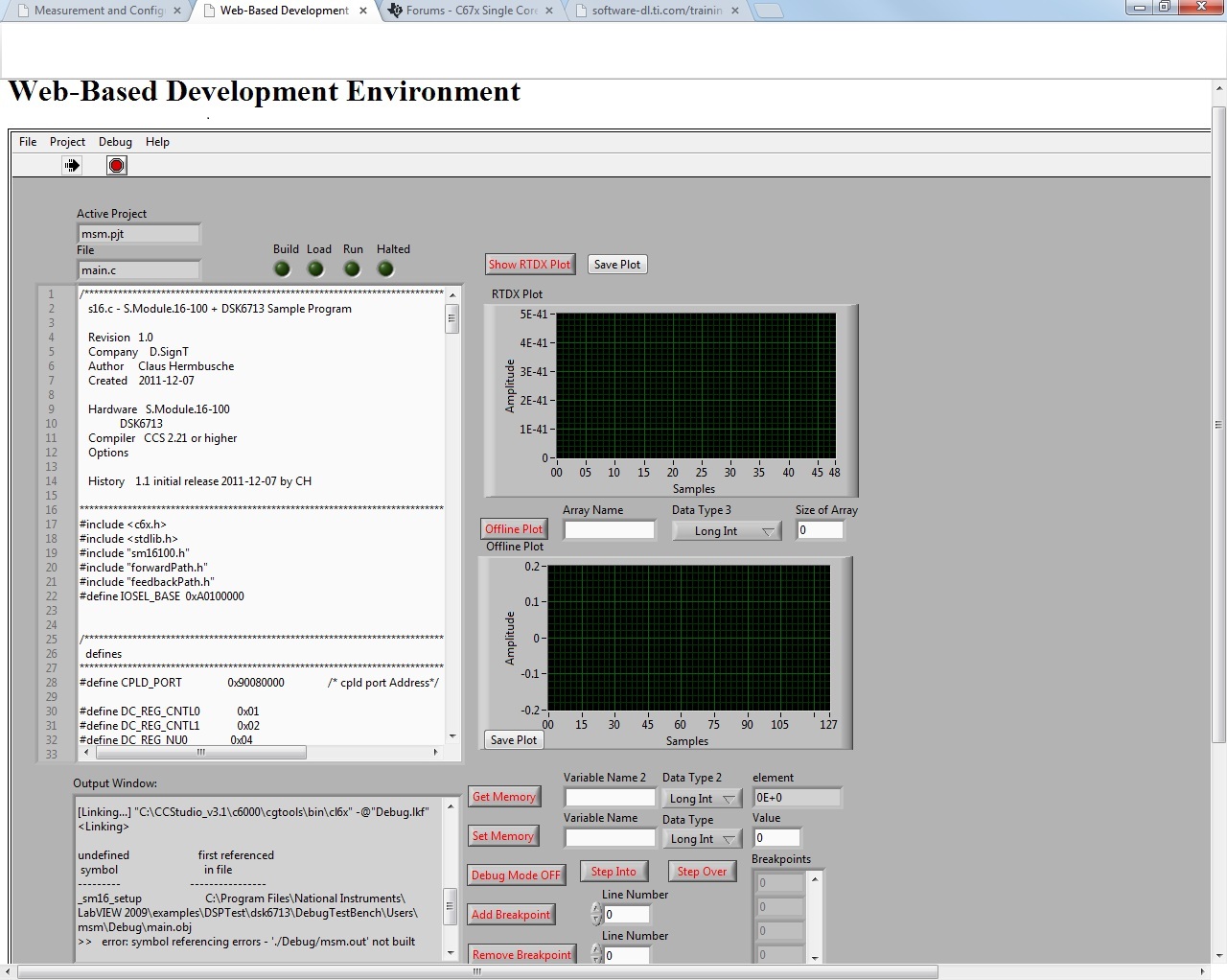

when i build my project i have this error.Kindly help me how i can resolve this issue.
undefined                              first referenced
symbol                                        in file
_sm16_setup                    C:\Program Files\-----------\examples\DSPTest\dsk6713\DebugTestBench\Users\msm\Debug\main.obj
>> error: symbol referencing errors - './Debug/msm.out' not built
>> Compilation failure
Build Complete,
2 Errors, 0 Warnings, 0 Remarks.

    This error message says that in one of your files, there is a symbol being referenced but the linker cannot find that symbol.
    The file main.obj probably was compiled from main.c, and in main.c you referenced a symbol sm16_setup. But the linker cannot find that symbol. You must find where that symbol is created and include that file or library in your project.

  • Hi Randy,
    In my code there is used sm16_setup. this initialize the sm16100 ADC module. and i have added the header file in my code sm16100.h where sm16_setup is initilized and other things relatd to board.
    Still i am having the same error. Is there any other way that i overcome this issue ?

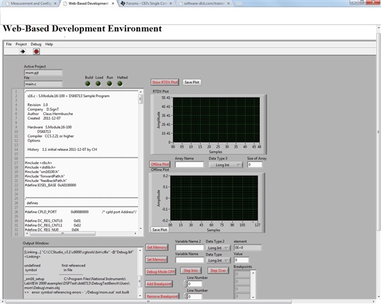

  • Hi Randy,
    I am following the link since from your 1st reply to this post.and sorry to tell you before that actually i am working on a remote laboratory where i can not have access to ccs directly.  User have to use web based environment. i am attaching a pictorial view for you.
    I think i need to talk to administrator for linking the file in CCS.
