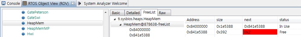

I got HeapMem out of memory message as below.
ti.sysbios.heaps.HeapMem: line 307: out of memory: handle=0x878638, size=3936
xdc.runtime.Error.raise: terminating execution
I assigned 16MBytes default Heap memory on DDR3 in the .cfg file
var heapMemParams                   = new HeapMem.Params;
//heapMemParams.size                  = 0x927C0;      // 600KBytes
heapMemParams.size                  = 0xF42400;       // 16MBytes
heapMemParams.sectionName           = "systemHeap";
Memory.defaultHeapInstance          = HeapMem.create(heapMemParams);
//Program.sectMap["systemHeap"]       = Program.platform.dataMemory;
Program.sectMap["systemHeap"]       = "DDR3_C1";
And, there's enough memory on the DDR3 Heap memory area.

In the ROV(HeapMem), I found something strange.
The Heap memory buffer starts at 0x84000000 with total size of 0xf42400(16M)
But, the FreeList says theres only 0x2 size if free
Did I miss something to do when assign Heap on DDR3?

  • The combination of your two posts makes me wonder if DDR3 memory and/or timing is being setup properly.  The ROV tool is reading memory to display its values, so it looks like it is seeing some sort of corruption for the free list too.  But by moving to static memory (L2SRAM) the issue Marcus saw was resolved.
    What platforms are you running on?  Are you initializing and setting proper timing for DDR3?  Either at runtime or with a GEL file?  Are you using this memory region for other purposes without issue?

    Someone mentioned that if using L2SRAM things work but when moving to DDR3, things don't work.  The most common problem why this is the case
    is that, each core has its own L2SRAM so when placing a heap in L2SRAM, each core's allocation does not affect another core's allocation.
    DDR3 on the other hand is shared, therefore you must make sure the Memory_alloc() don't clobber one another.  This can be done in 2 ways:
    1.  Use a multicore aware heap like HeapMemMP or HeapBufMP [Note the "MP" to denote MultiProcessor aware]
    2.  Slice your DDR3 yourself so that DDR3 is split among your different processors in the system and don't collide.
