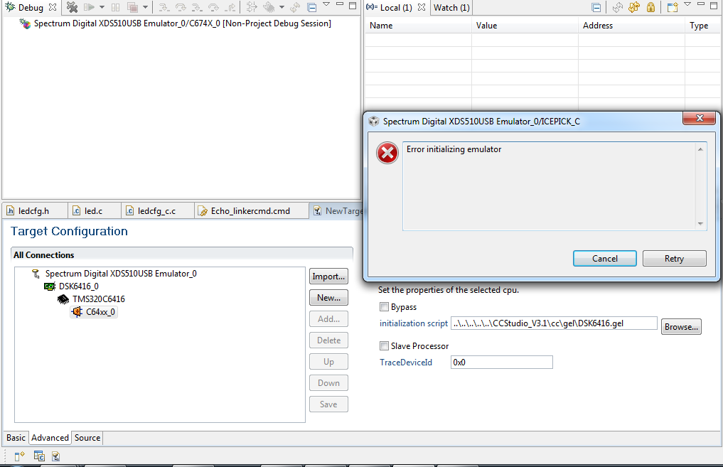

I have a 6416 DSK board and I worked with it in CCS 3.1 environment easily but Now I installed CCS 4.2 but I cannot connect the board to the PC.
my project Compiles successfully and I create an configuration file with  XDS510 USB emulator for programming the DSP but when I try to connect to the board an error window appears telling me that it has "Error in initializing the emulator" !!!! and nothing else ...
I don't know what to do ! I chose the right gel file for initialization ...    I've provided a snap shot of my screen below

    First, I am curious why you are using CCSv4.2 instead of CCSv5.3, which is the latest available.
    Second, the best place to start for figuring out the right emulation setup is the TI Wiki Pages looking at the article GSG:Common target configurations. Search on that page for DSK6416 to see details on what you need to use for configuring your board for emulation.
    Please let us know if this information is helpful, or if you still have problems with your connection.
