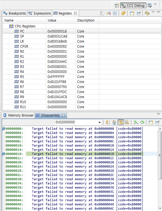

    --> if i enable even only 1 interrupt, IRQ jump to 0x02000018 instead 0x00000018, i made VINTH signal to "L" using CP15 command at boot.asm
    Below is my CCS dump after breakpoint at 0x02000018 using CCS V5.x
    Same Board and software, different Boot mode ??
    Thanks in advance
    For more information,
    I made an breakpoint at 0x02000018 and start the system.
    After jumping to 0x02000018, i did 2 things like below
        1. Compulsorily edit the PC to 0x80008040 which is the entry point of Application Code
            --> Do code initial and after enabling the interrupt,  again jump to 0x02000018
        2. Compulsorily edit the PC to 0x00000018 which has right IRQ vector.
            --> In this case, the system can't read the ARM internal memory like below CCS dump
    Thanks for reading.

  • Hennessy,
    If you read the ARM subsystem document, at section 11.1 in the boot mode overview the following paragraph
    "After reset (POR, warm reset, or max reset), ARM program execution begins in ARM ROM at 0x0000: 8000, except when BTSEL[2:0] = 001, indicating AEMIF (OneNand/NOR) flash boot. See Section 10 for information on the boot selection pins."
    I think this means that in NOR/OneNAND bootmode, it will not even jump to BootROM, which will might result in not initializing/powering up the IRAM memories. I hope this explanation is satisfactory.
  • Renjith
    The problem was solved when i re-enabled the I/D TCM even it already enabled .
    Thank you for your kind help.
    Best Regards
