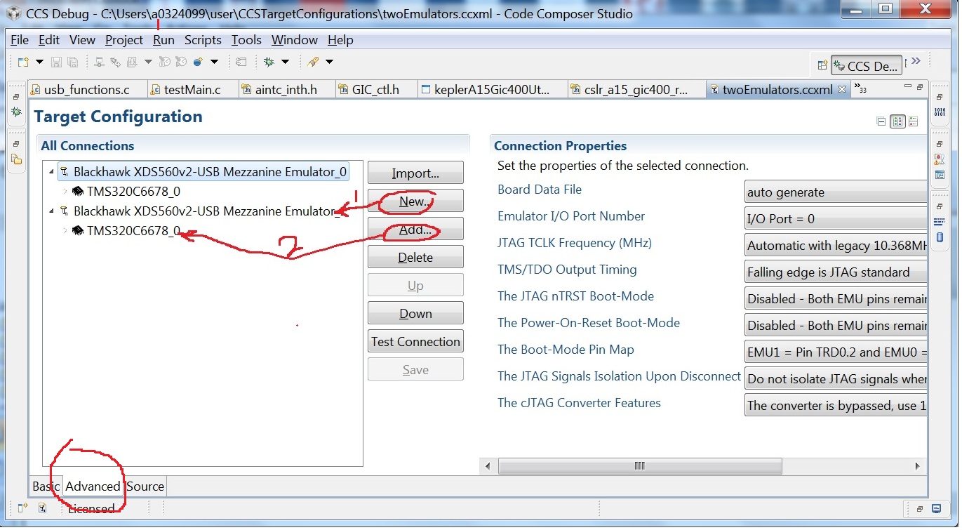

    See the attached screenshot I did. What you need to do is:
    1. Do what you normally do to create a target configuration for a single emulator case.
    2. In the target configuration window, click on "Advanced" tag, you will see only one emulator with one target (TMS320C6678) for now.
    3. Then, click the button "New", which will lead you to add a new emulator <select whatever the emulator you are using>.
    4. Then, clcik on the new emulator you just added in, and click the button "Add", which will lead you to add a device <TMS320C6678> with the emulator you just added.
    5. Click "Save" to save this configuration, which will be used for launch debug session with two emulators concurrently.
    6. Optionally, you can click on the "Test Connection" button to verify whether CCS can talk to each of the targets <click on one at a time, then click "Test Connection">

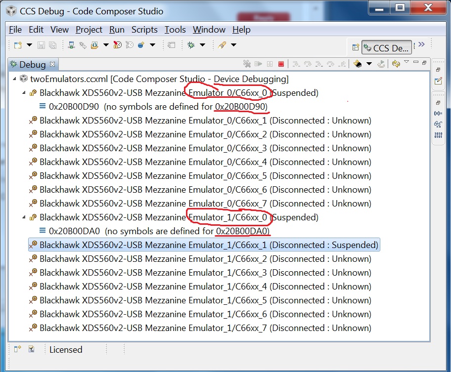

  • Can you be more specific on what you have done and what you have seen is wrong?  Regarding to why the "Test connection" is not available, can you tell me the version of the CCS you are using <the one I am using is v5.2.1.00018>?
    Attached is another screenshot I got. You can see that, CCS has connected to two C66xx_0 targets under different emulator (Emulator_0 and Emulator_1), and the two DSP targets stopped at the different PC locations - they are different. So, I need more details of the problem you have seen.
    Regards!
    Wen

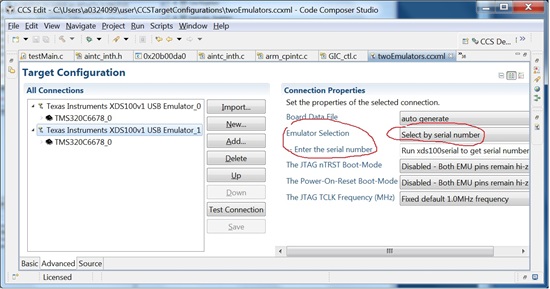

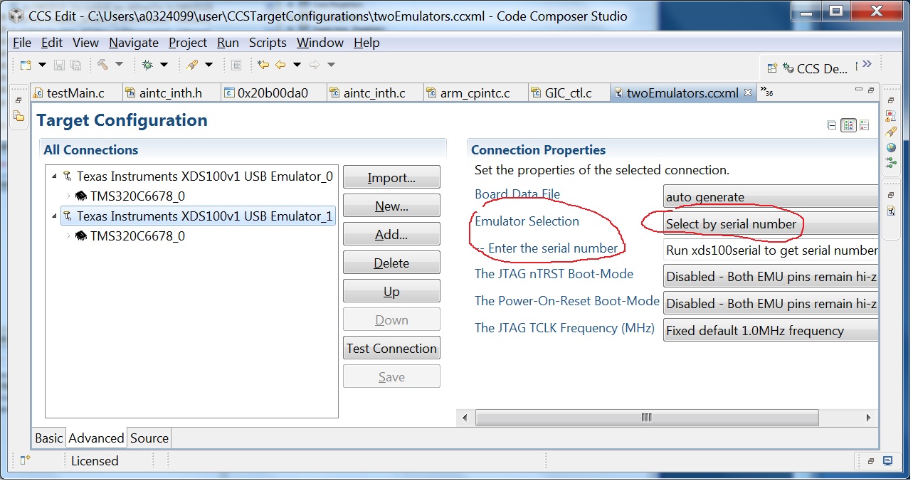

    I have just found this:
    "Having two XDS100v1 emulators are not supported but you can have one XDS100v1 and one XDS100v2 or two XDS100v2 emulators"
    http://processors.wiki.ti.com/index.php/Multi-Emulator_Debug_with_CCSv5
    So If i update my CCS, and With CCS version CCS 3.xxxx that will be done???
    Yes, you can have multiple xds100s, including XDS100v1. But you do have to put the serial number of each in the config. Under Emulator Selection in the target configuration, you need to use “Select by Serial Number”.  You do have to make that choice for all XDS100s connected to the PC when there are more than one.
    See the attached screenshot I got:
    Regards!
    Wen
