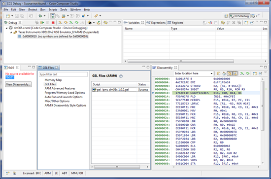

I'm trying to follow the instructions in the user guide and I'm getting stuck within the first few steps:

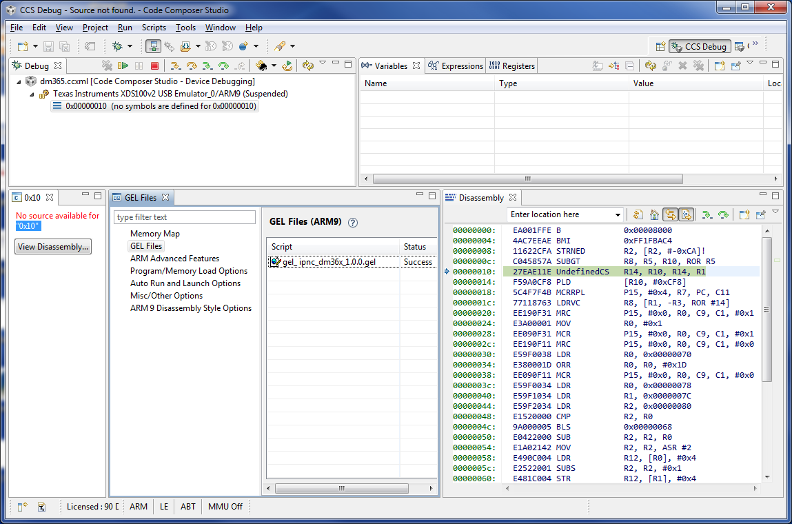

After that, I go to Tools -> GEL files and then load the gel file, and now when I'm trying to connect CCS to the target board I get an error message saying:
"No source available for "0x10".
This is a screenshot of what I get:
What am I doing wrong here?
Should I make a new project first? If so, what type of project?
Thanks.
  • EM,
    There is nothing wrong. It is trying to find the C source code for the assembly instructions at the offset 0x10 where program counter is pointing currently. Since you don't have the source code, you need not worry. You can press F8 for continue running or you can continue with the next step( loading the executable to target.).
    You'll keep seeing this many times. You can simply ignore.
