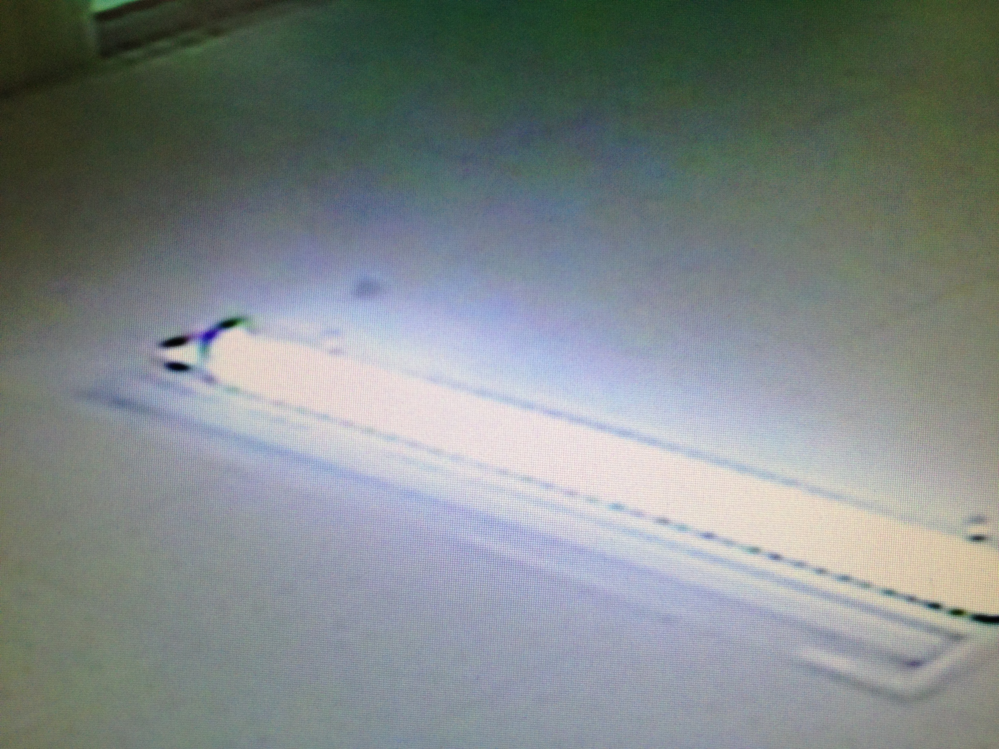

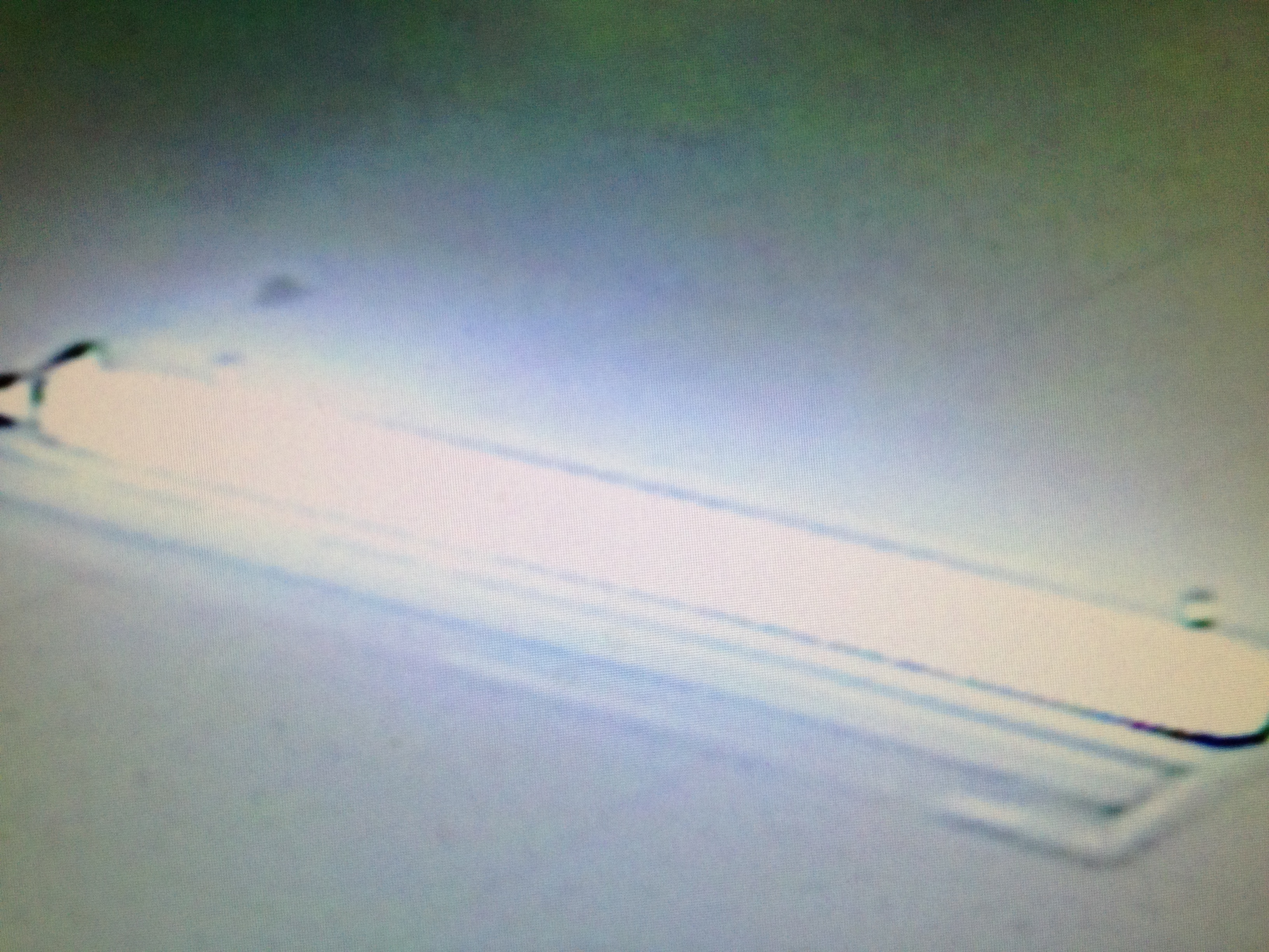

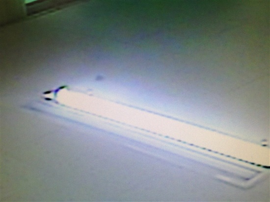

Hi.
i checked this issue(playback us not clarify) for a long time.
http://e2e.ti.com/support/dsp/davinci_digital_media_processors/f/717/t/237862.aspx?pi239031349=2
when i change playback mode , playback displayed video data is not clairfied , it's seen blured.
it is seen in the mode of MULTICH_LAYOUT_MODE_16CH . it's not seen MULTICH_LAYOUT_MODE_13CH and MULTICH_LAYOUT_MODE_4CH
thus i changed like belows. currently it's seen clarified. why it is not seen blured when i set force upscaling?
is there any check point scaling coeffs?

  • In addition. i checked the log with below func.
    when i checked Co-effs value live and pb, Co-effs value is same. i don't know why this issue occured.
    what do you think about that?

  • Hi . Thank you for your support.
    i checked another issue in the LAYOUT_1CH. i think if i tuning more little bit , it will be good.
     at the view of 45 degree's angle , sawtooth more noticeable.is there any point to imporve like RDK_03.00 images sawtooth?
    i attached my previous RDK image and patched current RDK image.
    1. DVRRDK_03.00.xx.00
    2. DVRRDK_03.50.00.05
    Best Regards. CHO
  • Can you pls try with the attached patches. We are not seeing the issue in our setup so we are not sure if it will resolve the issue:

  • Hi. Badri.
    i applied your patch.
    enable peaking is making the fluorescent light more flickered . i considering do not apply enabled-peaking patch.
    and when i check the encoded data( Check by playing the encoded .h264 stream for say primary channel #0 on a PC player), i can see the same artifacts .
    and when i backup and play two RDK(3.0 and 3.5) , 3.0 RDK backuped .h264 stream is more clear.  where can i check in the DEI VIP scaler.
    can you advice me some testing option at the DEI VIP scaler?
    thanks for your time and help.
    BR . CHO.

  • Hi Badri.
    after reverted your patch. 45 degree's line displayed clearly and there's no more atrifacts.
    in addition to when i test 960H mode, not reverted DEI  more noticeable and not good .
    i think if you have a chance to use another 960H supported video decoder, you can see it's serious.
    because we have a exhibition,   your support much helped for us.
    thank you for your time and help.
     Best Regards. CHO
