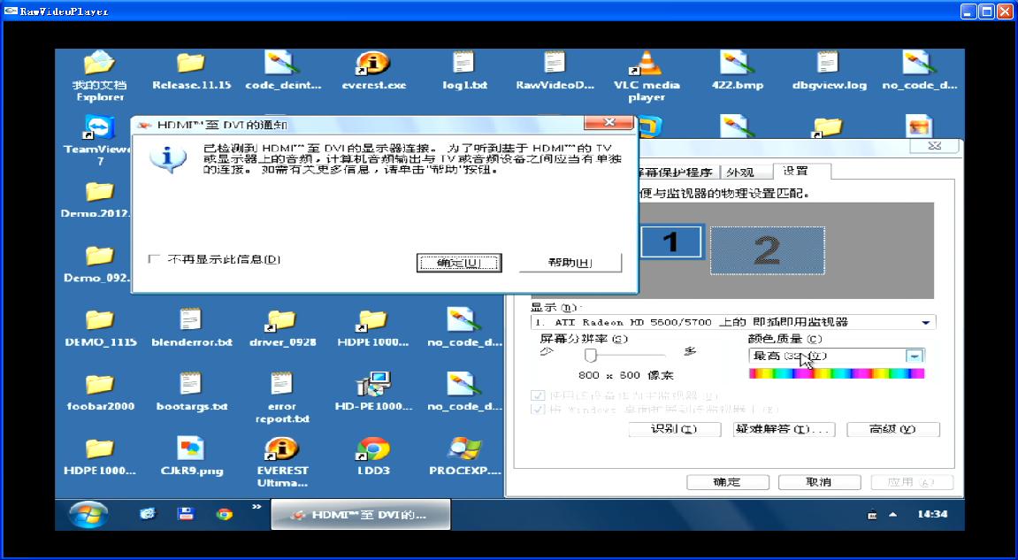

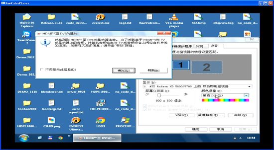

     I capture 800x600 with source of  PC DVI out, and I saved  the YUV data and showed it with  a tool  rawVedioPlayer.

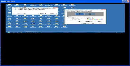

    the vedio i captured as follow  in a not right mode, because I use the 720P capture mode to  catch the 800x600, and if I use the 1080P capture mode, there will be only half screen of a whole picture,looks like interlaced vedio with one feild.
    I didn't use component convert, and i think may be ti81xxvin_main should changed some args or add a suitable mode for it...

  • Hi Away Liu,
    The current TVP driver in the kernel will not support 800X600 resolution. You will have to
    1. Code to configure TVP 7002 to detect 800X600
    2. Code to configure TVP 7002 to receive 800X600
    right now the TVP driver might be detecting some wrong resolution and configuring the same. Hence the image captured is wrong.
    3. The standard in VIP(capture) is used for buffer allocation.
    First lets detect the required resolution and configure TVP 7002 for same. After which we can look at capture driver configurations.
    Sujith
