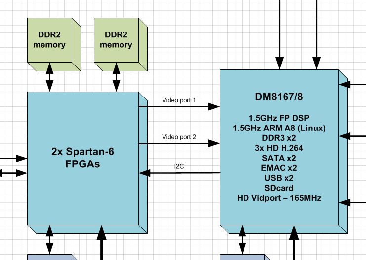

  •  Hi,
    You have to use a low-cost FPGA (like a small Spartan) and a frame-buffer in front of the HDVPSS to split data into multiple video streams. Sundance has got an IP-Core - sorry, self-promotion! - that is available as part of the our Capture Box for Dual streaming two channels of 2k by 2k @ 20FPS or two channels of 4k x 4k @ 10FPS. Although not tried, then it might be possible to do 4000x2000 on a single channel at a higher speed.
    Flemming
         It is possible to capture 4K if you decrease the framerate to something around 15fps, we have been able to capture 4K@15fps, also the codecs (MJPEG and H264) are able to handle the resolution. You would need to generate the correct signal and pixel clock using an FPGA as suggested above to inject 15fps and some changes in the M3 firmware to be able to get it working with OMX camera. Moreover, if you want to get it working with v4l2src you would need to modify the driver to specify the resolution.
