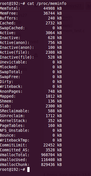

Appro DM368 Memory leak while writing data in SD card

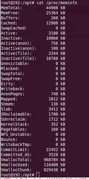

I have developed a sample program in which I have allocating a buffer of 10 MB and writing buffer into SD card. After writing code I am closing file and free allocated buffer of 10 MB. Surprisingly even after closing the application 10 MB memory free is not reflected in /pfoc/meminfo. For all subsequent execution of same application doesn't leak additional 10 MB memory but same time holding 10 MB memory of the first-time execution. No other application is running along with this application.
I am using DM36x IPCamera RDK v. 4.1 V based on Linux Kernel 2.6.37. Please let me know how to resolve it.
Following is the application code.

Following is the snapshot for Memory consumption before executing program
Following is the snapshot for Memory consumption after executing program
