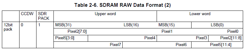

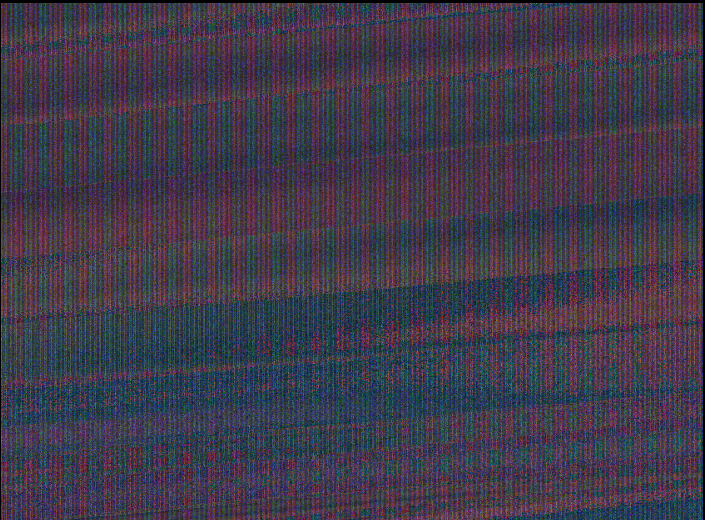

Appro DM368: Not able to capture 12 bit "PACKED" RAW image
I am not able to capture 12 bit "PACKED" RAW image on Appro DM368 [DM36x IPCamera RDK v. 4.1 V based on Linux Kernel 2.6.37]. As specified in datasheet I have configured "SDRPACK" register to 1 and "CCDW" to zero. But I always get 16 bit (means 12 bit unpacked) RAW image. This mode is very important for me because that will save significant amount of memory.
Following is the register dump [also attached same register dump in separate file for readability purpose]. Please let me know what I am missing over here.

  • HK,
    I verified on my 1080P IPNC with RDK 3.1 by manually changing SDRPACK to 1 and HSIZE (0x1c71034) to 0x5a (1920*2/4*3/32).
    The 1920x1088 raw image captured by ITT is both correctly packed in 12-bit mode and in the correct memory line offset (3840 bytes/line).
    Gang

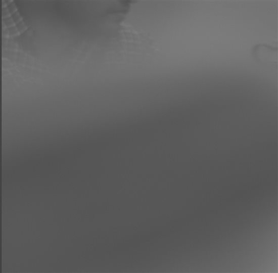

  • Hi Gang,
    I have modify HSIZE to 0x7A (2592*1.5/32). I got the image with with size of 7.347 MB but the image is not proper. In addition to that I can see padding bits available in the image dump also. I am attaching the image and file dump both. Did you chek the image that you have captured in 1080 P, was it proper? Can you share the ISIF register dump with me, so I can compare if anything I missed out.
    6765.DATA0001_52.490.zip
    --HK
  • Your line offset in the rawTI file (after removing header with size 27328 bytes) is 1952 (0x7a*32/2).
    However, it is not 12-bit packed for some reason.

    (4) the second image looks the same after 12-bit unpacking as the first image
  • Hi Gang,
    Thanks a lot for your continuous help. I will compare your register dump and try to produce the same on my setup.
    Can you please share the name of image viewer you are using to decode TI RAW data?
    --HK
  • The rawTI (with header) or raw (w/o header) files can be viewed in ITT (IPIPE GUI/File/Open raw file).
    However, there is a bug for displaying 12-bit packed data (other formats are fine).
    So, you have to manually unpack to 16-bit first.
