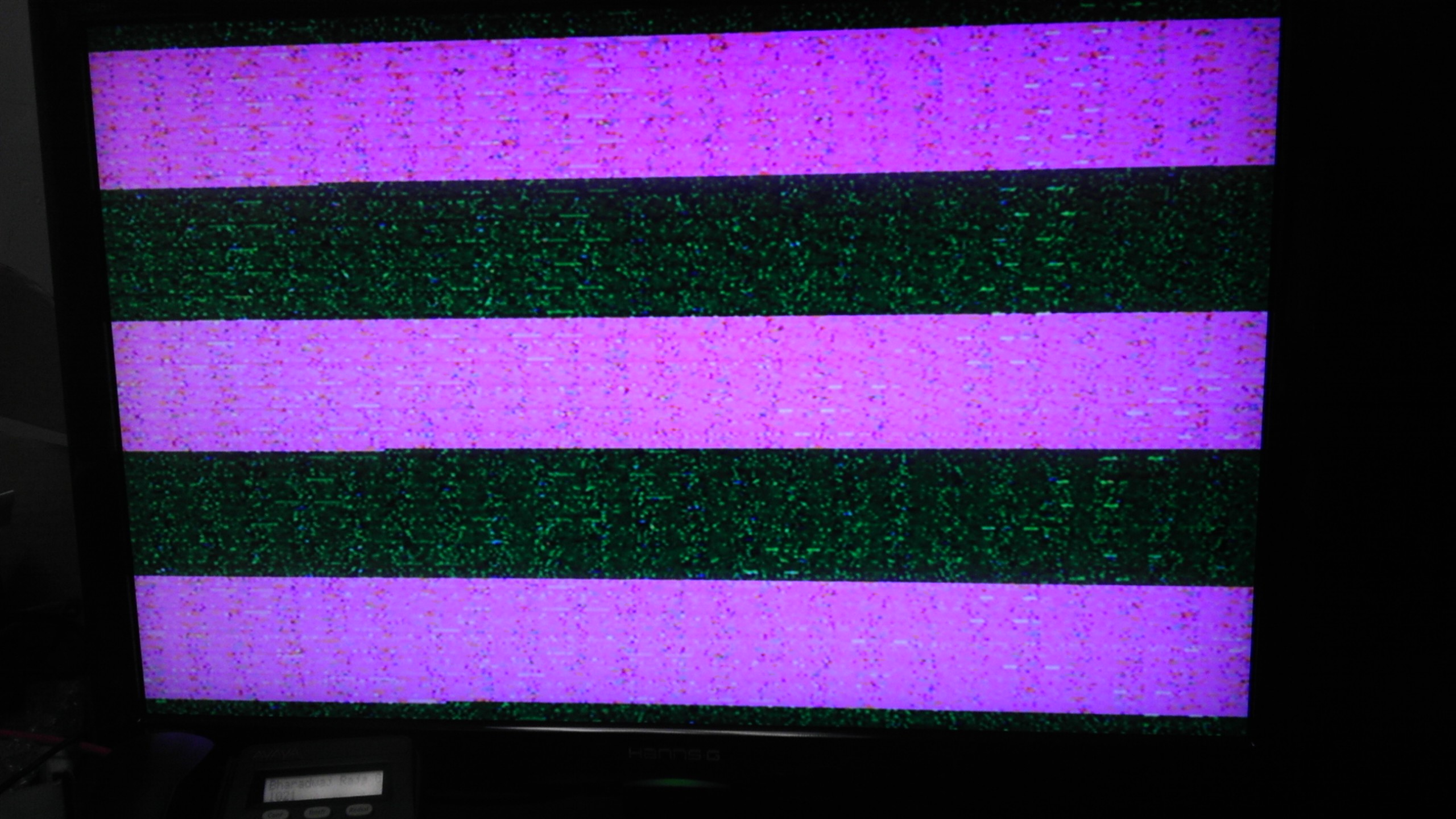

Hi all,
We've used a TVP5150 chip with the TI DM8168 processor to display CVBS & Y/C video.  We have connected the TVP5150 to VIP1 PORTB of the DM8168 processor & we have verified all the hardware signals correctly.  However, when we are trying to display an NTSC input scaled to a 480i via DM8168 & output on HDMI, we are not seeing a correct output.  I've verified all the signals & also referred the DM8168 HW user guide, checked the I2C signals on the TVP5150 & also checked this post: http://e2e.ti.com/support/dsp/davinci_digital_media_processors/f/717/t/167746.aspx?pi239031349=1 & I've tried to best use all possibilities.

I'm still seeing only the attached jpeg output from an NTSC source.
I see the bars move with the source but still not displaying correct output. Any ideas on what I'm missing?  Thanks,

    Instead of running the saLoopBack, try running saCapture and dump the buffer in file and try to see it through YUV player. You can also send me dump of register address 0x48105500 first 100 registers and 0x48105a00 same first 100 registers.

    We're not using the saLoopBack or the saCapture application. We have our own that will capture signals & has been working great to capture HDMI, VGA & DVI signals. Looking at the TVP5150 I2C dump, do you think there are any mismatches in the registers?  I'm trying both NTSC J & NTSC 4.43 -60Hz signals to see if either works. Thanks,

    I have not gone through whole TVP5150 dump but what you can do is that you can send few important register dump with description and i will try to look into it. But VIP dump is also important and send that also to make sure that both VIP and TVP register are in sync to see the data format.

    I've attached a file that will give the TVP5150 register specs & here's the dump of the VIP (HDVPSS_INST0):

    All the registers are 0x00. There could be following possiblities.
    1. Dump is taken before starting capture.
    2. Some bug in your code modification where capture is not starting.
    3. Capture is starting on another video port and you are taking dump of video port 1.
    Hardik Shah
  • Hi Hardik,
    1. Dump is taken definitely while capture is happening (I see the screen mentioned in picture above)
    2. I believe the capture is starting because I see the code entering NTSC mode & trying to output NTSC mode via DM8168 (that is scaled to 480i).
    3. I took a dump of the VIP1 & here is that dump:

    The earlier dump was for VIP0 & I made a mistake of sending you that dump.  We are trying to capture on VIP1 for the TVP5150 & this is the correct one. Thanks,
    Bharadwaj
