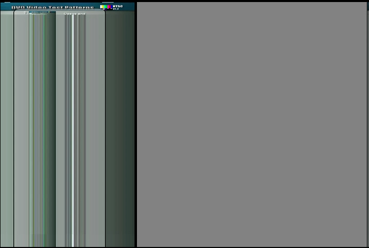

  • Hello, Badri.
    We try to reproduce the case above. We have exactly the same use schema as in this thread. Our video decoder is TVP5151, which we control externally.
    Below is the resulting video we receive:
    The use case file look like this:
    TVP5151 (YUV422P)
    Capture (YUV420SP)
    DEI (DEI-SC)
    NSF
    (YUV420SP)
    IPCM3OUT(VPSS)
    IPCM3IN(VID)----ENC-----IPCBITS_RTOSOUT(VID)
    IPCBITS_HLOSIN(HOST)
    FILE-(H264)

    pCaptureInstPrm->videoIfMode = DEVICE_CAPT_VIDEO_IF_MODE_8BIT;
    pCaptureInstPrm->inScanFormat = SYSTEM_SF_INTERLACED;
    pCaptureInstPrm->videoDecoderId = 0;
    pCaptureInstPrm->inDataFormat = SYSTEM_DF_YUV422P;
    pCaptureInstPrm->standard = SYSTEM_STD_NTSC;
    pCaptureInstPrm->numOutput = 1;
    pCaptureOutPrm = &pCaptureInstPrm->outParams[0];
    pCaptureOutPrm->dataFormat = SYSTEM_DF_YUV420SP_UV;
    pCaptureOutPrm->scEnable = FALSE;
    pCaptureOutPrm->scOutWidth = 0;
    pCaptureOutPrm->scOutHeight = 0;
    pCaptureOutPrm->outQueId = 0;
    deiPrm.inQueParams.prevLinkId = gVcapModuleContext.captureId;
    deiPrm.inQueParams.prevLinkQueId = 0;
    deiPrm.outScaleFactor[DEI_LINK_OUT_QUE_DEI_SC][0].scaleMode = DEI_SCALE_MODE_ABSOLUTE;
    deiPrm.outScaleFactor[DEI_LINK_OUT_QUE_DEI_SC][0].absoluteResolution.outWidth = 720;
    deiPrm.outScaleFactor[DEI_LINK_OUT_QUE_DEI_SC][0].absoluteResolution.outHeight = 240;
    deiPrm.setVipScYuv422Format = FALSE;
    deiPrm.enableDeiForceBypass = FALSE;
    deiPrm.enableForceInterlacedInput = TRUE;
    deiPrm.outputFrameRate[DEI_LINK_OUT_QUE_DEI_SC] = 60;
    deiPrm.enableOut[DEI_LINK_OUT_QUE_DEI_SC] = TRUE;
    deiPrm.enableOut[DEI_LINK_OUT_QUE_VIP_SC] = FALSE;
    deiPrm.enableOut[DEI_LINK_OUT_QUE_VIP_SC_SECONDARY_OUT] = FALSE;
    deiPrm.outQueParams[DEI_LINK_OUT_QUE_DEI_SC].nextLink = gVcapModuleContext.nsfId[0];
    deiPrm.comprEnable = FALSE;
    nsfPrm.bypassNsf = TRUE;
    nsfPrm.tilerEnable = TILER_ENABLE;
    nsfPrm.inQueParams.prevLinkId = gVcapModuleContext.deiId[0];
    nsfPrm.inQueParams.prevLinkQueId = DEI_LINK_OUT_QUE_DEI_SC;
    nsfPrm.numOutQue = 1;
    nsfPrm.outQueParams[0].nextLink = ipcOutVpssId;
    nsfPrm.numBufsPerCh = NUM_NSF_BUFFERS;
    nsfPrm.inputFrameRate = 30;
    nsfPrm.outputFrameRate = 30;
    ipcOutVpssPrm.inQueParams.prevLinkId = gVcapModuleContext.nsfId[0];
    ipcOutVpssPrm.inQueParams.prevLinkQueId = 0;
    ipcOutVpssPrm.numOutQue = 1;
    ipcOutVpssPrm.outQueParams[0].nextLink = ipcInVideoId;
    ipcOutVpssPrm.notifyNextLink = TRUE;
    ipcOutVpssPrm.notifyPrevLink = TRUE;
    ipcOutVpssPrm.noNotifyMode = FALSE;
    ipcInVideoPrm.inQueParams.prevLinkId = ipcOutVpssId;
    ipcInVideoPrm.inQueParams.prevLinkQueId = 0;
    ipcInVideoPrm.numOutQue = 1;
    ipcInVideoPrm.outQueParams[0].nextLink = gVencModuleContext.encId;
    ipcInVideoPrm.notifyNextLink = TRUE;
    ipcInVideoPrm.notifyPrevLink = TRUE;
    ipcInVideoPrm.noNotifyMode = FALSE;
    EncLink_ChCreateParams *pLinkChPrm;
    EncLink_ChDynamicParams *pLinkDynPrm;
    VENC_CHN_DYNAMIC_PARAM_S *pDynPrm;
    VENC_CHN_PARAMS_S *pChPrm;
    EncLink_CreateParams_Init(&encPrm);
    encPrm.numBufPerCh[0] = NUM_ENCODE_D1_BUFFERS;
    encPrm.numBufPerCh[1] = NUM_ENCODE_CIF_BUFFERS;
    /* Primary Stream Params - D1 */
    for (i=0; i<gVencModuleContext.vencConfig.numPrimaryChn; i++)
    pLinkChPrm = &encPrm.chCreateParams[i];
    pLinkDynPrm = &pLinkChPrm->defaultDynamicParams;
    pChPrm = &gVencModuleContext.vencConfig.encChannelParams[i];
    pDynPrm = &pChPrm->dynamicParam;
    pLinkChPrm->format = IVIDEO_H264HP;
    pLinkChPrm->profile = gVencModuleContext.vencConfig.h264Profile[i];
    pLinkChPrm->dataLayout = VCODEC_FIELD_SEPARATED;
    pLinkChPrm->fieldMergeEncodeEnable = FALSE;
    pLinkChPrm->enableAnalyticinfo = pChPrm->enableAnalyticinfo;
    pLinkChPrm->enableWaterMarking = pChPrm->enableWaterMarking;
    pLinkChPrm->maxBitRate = pChPrm->maxBitRate;
    pLinkChPrm->encodingPreset = pChPrm->encodingPreset;
    pLinkChPrm->rateControlPreset = pChPrm->rcType;
    pLinkChPrm->enableSVCExtensionFlag = pChPrm->enableSVCExtensionFlag;
    pLinkChPrm->numTemporalLayer = pChPrm->numTemporalLayer;
    pLinkDynPrm->intraFrameInterval = pDynPrm->intraFrameInterval;
    pLinkDynPrm->targetBitRate = pDynPrm->targetBitRate;
    pLinkDynPrm->interFrameInterval = 1;
    pLinkDynPrm->mvAccuracy = IVIDENC2_MOTIONVECTOR_QUARTERPEL;
    pLinkDynPrm->inputFrameRate = pDynPrm->inputFrameRate;
    pLinkDynPrm->rcAlg = pDynPrm->rcAlg;
    pLinkDynPrm->qpMin = pDynPrm->qpMin;
    pLinkDynPrm->qpMax = pDynPrm->qpMax;
    pLinkDynPrm->qpInit = pDynPrm->qpInit;
    pLinkDynPrm->vbrDuration = pDynPrm->vbrDuration;
    pLinkDynPrm->vbrSensitivity = pDynPrm->vbrSensitivity;
    /* MJPEG Params */
    for (i=gVencModuleContext.vencConfig.numPrimaryChn + gVencModuleContext.vencConfig.numSecondaryChn;
    i<(VENC_CHN_MAX); i++)
    pLinkChPrm->format = IVIDEO_MJPEG;
    pLinkChPrm->profile = 0;
    pLinkChPrm->enableAnalyticinfo = 0;
    pLinkChPrm->enableWaterMarking = 0;
    pLinkChPrm->maxBitRate = 0;
    pLinkChPrm->encodingPreset = 0;
    pLinkChPrm->rateControlPreset = 0;
    pLinkChPrm->enableSVCExtensionFlag = 0;
    pLinkChPrm->numTemporalLayer = 0;
    pLinkDynPrm->intraFrameInterval = 0;
    pLinkDynPrm->targetBitRate = 100*1000;
    pLinkDynPrm->interFrameInterval = 0;
    pLinkDynPrm->mvAccuracy = 0;
    pLinkDynPrm->qpMin = 0;
    pLinkDynPrm->qpMax = 0;
    pLinkDynPrm->qpInit = -1;
    pLinkDynPrm->vbrDuration = 0;
    pLinkDynPrm->vbrSensitivity = 0;
    encPrm.inQueParams.prevLinkId = ipcInVideoId;
    encPrm.inQueParams.prevLinkQueId = 0;
    encPrm.outQueParams.nextLink = gVencModuleContext.ipcBitsOutRTOSId;
    ipcBitsOutVideoPrm.baseCreateParams.inQueParams.prevLinkId = gVencModuleContext.encId;
    ipcBitsOutVideoPrm.baseCreateParams.inQueParams.prevLinkQueId = 0;
    ipcBitsOutVideoPrm.baseCreateParams.numOutQue = 1;
    ipcBitsOutVideoPrm.baseCreateParams.outQueParams[0].nextLink = gVencModuleContext.ipcBitsInHLOSId;
    MultiCh_ipcBitsInitCreateParams_BitsOutRTOS(&ipcBitsOutVideoPrm, TRUE);
    ipcBitsInHostPrm[0].baseCreateParams.inQueParams.prevLinkId = gVencModuleContext.ipcBitsOutRTOSId;
    ipcBitsInHostPrm[0].baseCreateParams.inQueParams.prevLinkQueId = 0;
    ipcBitsInHostPrm[0].baseCreateParams.numOutQue = 1;
    MultiCh_ipcBitsInitCreateParams_BitsInHLOS(&ipcBitsInHostPrm[0]);
    System_linkCreate (gVcapModuleContext.captureId, &capturePrm, sizeof(capturePrm));
    System_linkCreate(gVcapModuleContext.deiId[0], &deiPrm, sizeof(deiPrm));
    System_linkCreate(gVcapModuleContext.nsfId[0] , &nsfPrm, sizeof(nsfPrm));
    System_linkCreate(ipcOutVpssId , &ipcOutVpssPrm , sizeof(ipcOutVpssPrm) );
    System_linkCreate(ipcInVideoId , &ipcInVideoPrm , sizeof(ipcInVideoPrm) );
    System_linkCreate(gVencModuleContext.encId, &encPrm, sizeof(encPrm));
    System_linkCreate(gVencModuleContext.ipcBitsOutRTOSId, &ipcBitsOutVideoPrm, sizeof(ipcBitsOutVideoPrm));
    System_linkCreate(gVencModuleContext.ipcBitsInHLOSId, &ipcBitsInHostPrm[0], sizeof(ipcBitsInHostPrm[0]));
    System_linkGetInfo(gVencModuleContext.ipcBitsInHLOSId,&bitsProducerLinkInfo);
    OSA_assert(bitsProducerLinkInfo.numQue == 1);
    printf ("\n\n========bitsProducerLinkInfo============\n");
    printf ("numQ %d, numCh %d\n",
    bitsProducerLinkInfo.numQue,
    bitsProducerLinkInfo.queInfo[0].numCh);
    int i;
    for (i=0; i<bitsProducerLinkInfo.queInfo[0].numCh; i++)
    printf ("Ch [%d] Width %d, Height %d\n",
    i,
    bitsProducerLinkInfo.queInfo[0].chInfo[i].width,
    bitsProducerLinkInfo.queInfo[0].chInfo[i].height
    printf ("\n====================\n\n");
    if (bitsProducerLinkInfo.queInfo[0].numCh > gVencModuleContext.vencConfig.numPrimaryChn)
    bitsProducerLinkInfo.queInfo[0].numCh = gVencModuleContext.vencConfig.numPrimaryChn;
    printf ("Reducing bitsProducerLinkInfo.numCh to %d\n", bitsProducerLinkInfo.queInfo[0].numCh);
    We shall be very very thankful to you for any hint why we have this situation.

  • Hello, Shabir.
    May be you will be so kind to share your usecase file?
    It will help us a lot, as we have the same usecase as you had.
    Many many thanks ahead.
    Leon
  • Hello Leon,
    Could you tell me what SOC and software version you are using?
    Support for DVR-RDK is limited now, as pointed by Margarita.
    Meanwhile, could you please try modifying the usecase by setting the following-
    pCaptureInstPrm->standard = SYSTEM_STD_D1
    and
    deiPrm.outScaleFactor[DEI_LINK_OUT_QUE_DEI_SC][0].absoluteResolution.outHeight = 480
    Prashant.;
