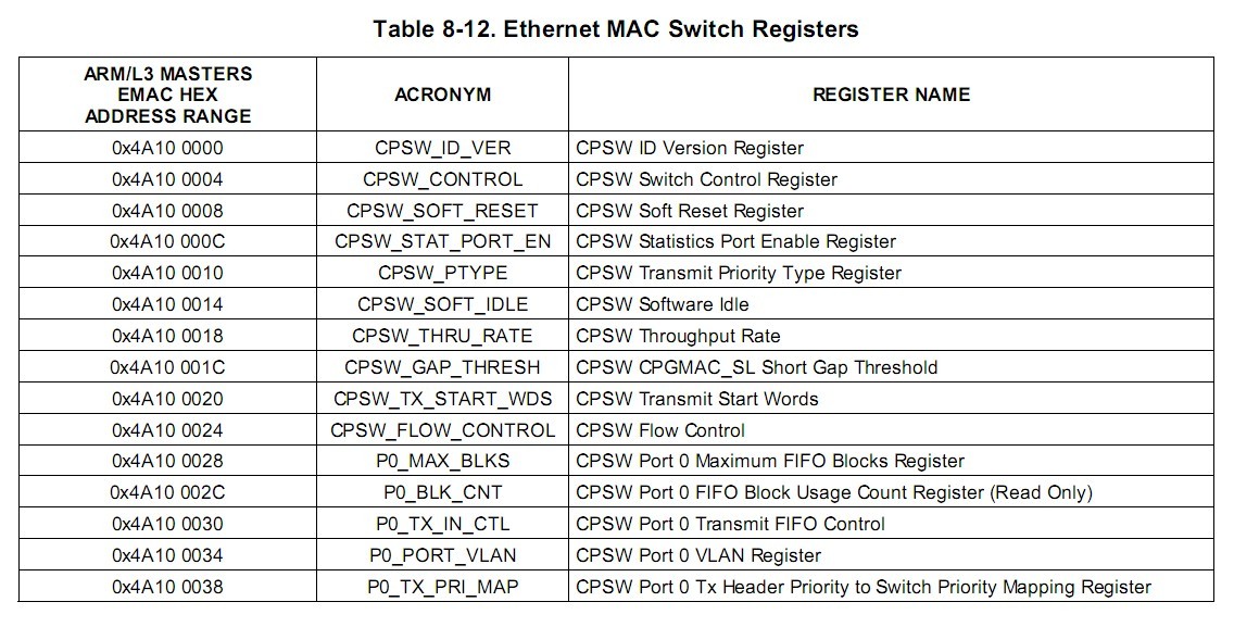

I am  using u-boot-2010.06-psp04.01.00.06.patch1
In drivers/net/Davinci_emac.h,there is a  emac_regs definition.

} emac_regs;
static volatile emac_regs *adap_emac = (emac_regs *)0x4A100000;
It looks the same with c6748's emac register ,but confict with DM8148's
Fllow is the 8148 emac  register
the 4A10 000C is cpsw_stat_port_en,but the register is reserved .
What I wana do is make sure the dsp can visit emac.
Now I can make the dm8148 link with the pc ,and rx/tx packet right on dsp side, the next step I wana add interrupt and dma to improve efficiency.When I wana refrence the Linux code ,find this bug I think.Who can slove doubet or  help me add DMA and emac interrupt to the dsp side.
Hope for your reply.
    Is there any reason in particular to use that u-boot psp?
    Is the situation the same on more recent u-boot like "u-boot-2010.06-psp04.04.00.01".
    I am not sure that I understand, but this table contains the ARM addresses. If want to access the EMAC from the DSP, I think the base address should be 0x0A10_0000 according to "Table 2-5. L4 Fast Peripheral Memory Map" around page 26 in the device datasheet.
    Thank you.
    BR
    Vladimir
