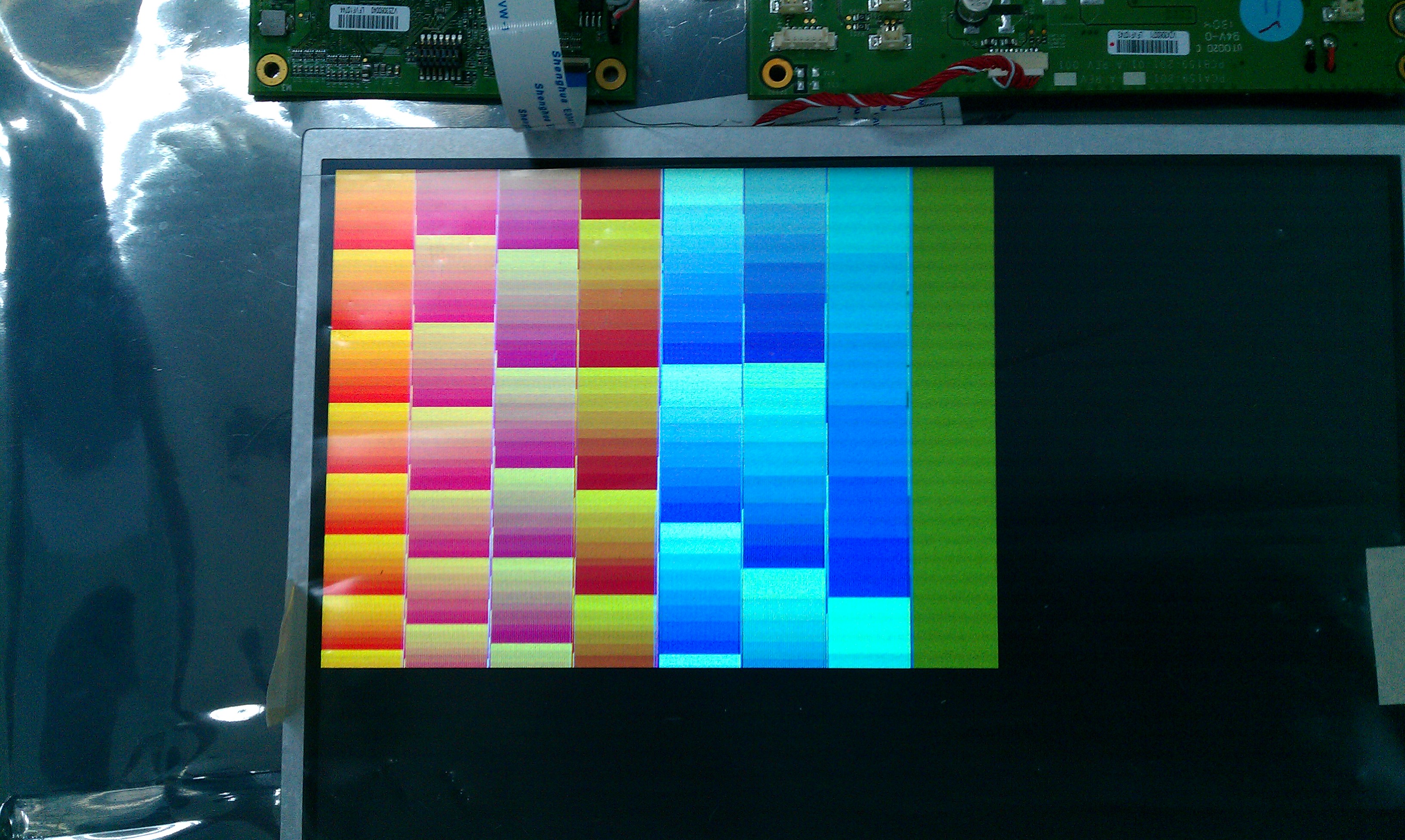

  • Hi Hardik,
    One more question regarding saLoopBack.
    The camera out is YUV422 and our LCD is RGB888.
    Currently, I'm checking the camera output by setting the camera to output color bar image.
    The color seem to be wronged.
    I read from TI8148 TRM that colorspace conversion is supported.
    Can I confirm if I configure the LCD as follows:
    echo triplediscrete,rgb888 > /sys/devices/platform/vpss/display1/output
    And the attached is the saLoopBack that I'm running.
    Please help to advise if the setupDisplay in saLoopBack is configured correctly.

    Yes it should work. Are you able to see correct color bar from capture. If  you dump color bar in file are you able to see correct yuv color. If you are seeing correct yuv colors and then you give this to display with above configuration as RGB  you should see correct colors.
  • Hi Hardik,
    I set the camera to output color bar test pattern to VIN[1] port A and the image displayed on the LCD is as attached.
    This is the expected image:
    Are you able to advise what could be wrong?
    Thank you.
    May
  • Hi Hardik,
    Sorry, the image from the camera is as follows:
    May
  • What is your input capture size? 1080P30, or 1080P60,or other format?
  • The input capture size is 640 x 480 at 30fps. YUV422, YUYVYUYV format.
  • Hi Hardik,
    I dumped out the capture buffer before passing to display queue and found that captured data is shifted left by 1 byte as compared to the camera data output captured on the camera EVM.
    Data are zeroes after 576,147th count.
    Please help to highlight which are the areas that could result in these issues?
    Thank you.
    May

    When executing saLoopBack, no error reported, just the image is wrong.
    May
  • Hi all,
    I found the problem that caused the color bar to display gradient in each bar.
    Its caused by a register setting in the camera hence it generate the output in this matter.
    Thank you all for your help extended.
