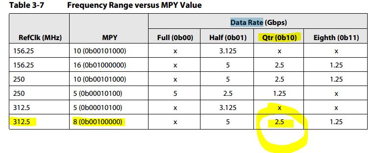

       We were trying to configure the SRIO Switch for 2.5Gbaud. But we can able to configure only for 1.25Gbaud.
       We can't able to perform the internal-loopback in C6678 through SRIO switch in c6678(REV-2.0). But we can able to perform the internal-loopback in C6678 through SRIO switch in c6678(REV-1.0).
        Reference code for the SRIO Switch?

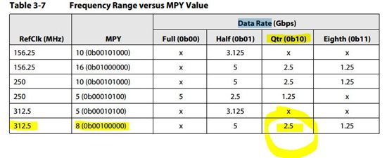

    Have you looked at the Table 3-7 in the SRIO User Guide?
    http://www.ti.com/lit/ug/sprugw1b/sprugw1b.pdf
    If you are using the C6678, then you have a reference clock of 312.5 MHz so that means you need an MPY of 8 at a quarter rate.

    1. Have you looked at the Table 3-7 in the SRIO User Guide?
    We were proceding according to the table 3-7in the SRIO user Guide.

    PROBLEM:
    The Reference clock for our Board is highleted in RED COLOR
    Port OK is set but Input Error and Ouput Error also set at the dsp and
    switch side. We cleared those errors as mentioned in Software error
    recovery procedure at both sides. But again same input and output error
    bit are set.
