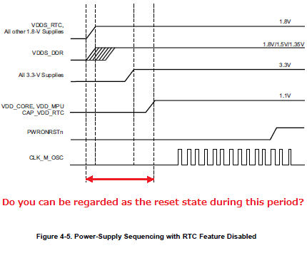

  • RY,
    I don't understand what's the problem here. What do you expect to happen during power-up, when neither processor, or EMIF or DDR are initialised?
  • Biser-san,
    Because it is requirement of JEDEC standard for DDR, I have to take care about whether the ODT and CKE are able to maintain the L level during this period.
    Can I think it is satisfied? (Are both ODT and CKE "L level" on the Figure above?)
    Best regards, RY
  • Hi RY,
    Of course it is satisfied. There are thousands of AM335X boards already manufactured with DDR2 memory. If you use a TI recommended PMIC and follow the datsheet design guidelines everything will be OK.

  • RY,
    I reviewed your concern. I'm presuming you are following all the power up sequencing requirements that are listed in the data sheet.
    Case 1: If you are ramping VDDS and VDDS_DDR supplies together.
    As the PWRONRSTn is held low and when VDDS and VDDS_DDR supplies are ramped to a certain threshold voltage (about 1V), an internal weak pull down pulls the CKE and ODT terminals low. This will guarantee that the CKE and ODT terminals will stay low even before the entire supply power up sequencing is completed.
    Case 2: If you are ramping VDDS supply first and VDDS_DDR follows VDDS.
    As the PWRONRSTn is held low and VDDS is fully ramped or reaches a certain threshold voltage (about 1V) AND VDDS_DDR voltage reaches a certain threshold voltage (about 1V), an internal weak pull down resistor pulls the CKE and ODT terminals low. This will guarantee that the CKE and ODT terminals will stay low even before the entire supply power up sequencing is completed.
    Given this, we should meet the DDR specification to maintain CKE and ODT low. DDR2 memories required CKE to be low to tri-state the data bus and avoid any contention with the Processor also driving data bus. This situation will never occur on AM335x due to the fact that AM335x never drives the data bus during initialization but just enables a weak pull and protect the inputs from floating.
    Please let us know if you have any more queries on this.

  • RY
    Just to confirm again - the pad state during power on is not just for CKE and ODT but for all the pins. Basically, after VDDS supply reaches a certain threshold voltage and the power supply for the corresponding IO terminal reaches a certain threshold voltage, AM335x pad state would be defined as noted in the data sheet when held under Reset. This is true before the entire power supply sequencing is complete.
    Please let us know if you have any further queries to close this issue.
    Regards, Siva

    Best regards, RY
  • RY
    AM335x pad state defined in the data sheet is valid when VDDSHVx is set as 1.8V or 3.3V. Basically, VDDS and VDDSHVx have to reach the required threshold voltage for the pull values to take effect.
    >> Can I think there are some circuits to prevent it on DDR?
    There are weak internal pull up/down resistors available on the DDR IO terminals if required. Details on this are covered in TRM section 9.3.89/9.3.90
    Please let me know if you have any other queries.
    Regards, Siva

  • Siva-san,
    Thank you very much for your answer.
    Think about the case that VDDSHV6 is configured as 3.3V. (I emphasize that VDDSHV6 is the power supply voltage of PWRONRSTn)
    During power on sequence, the period which 1.8V is ON and 3.3V is OFF, can it be considered as all the pins powered from 1.8V are reset state defined in the datasheet? (Of course PORz is L level.)
    I guess there is some kind of mechanism on PWRONRSTn.
    It is because the power of PWRONRSTn (that is 3.3V) is not supplied to the VDDSHV6 yet in the period which I described above.
    Why can you know that PWRONRSTn is L level?
    Best regards, RY
