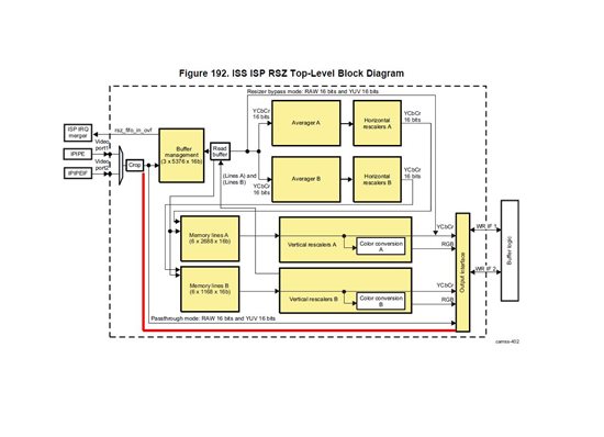

Hi all
How can I set in ISS so that I can achieve the "Passthrough mode" ??? I've tried many ways but failed !!!
the route is as below (red route):
thanks a lots
best regards

Hi Steven,
How are you setting pass through mode? You will have to set bit 1 of the register RSZ_SRC_FMT0? Could you please check if this is set?

Hi ,Brijesh Jadav
thanks for your reply!! I've checked the files "resizer_cred.h " , it define RESIZER__RSZ_SRC_FMT0__BYPASS to "BITFIELD(1, 1) "!!
Could you give more details since I don't understand well about it!! thanks !!!

Hi Steven,
Look into this file and check how to set this bit. This bit is used for the selecting the path you want.

Hi ,Brijesh Jadav
Is there any other file i need to look into ????
Since I dont understand the whole process well , could you give me more suggestions or ways to fix it! I've tried many times but failed
Thanks a lots
best regards
Resizer is handled in this file, so you could change in this file. i am not sure if this getting accessed anywhere else. But you can always hard code.

Hi Brijesh Jadav
I've tried it for many days but failed !!!!!
Do you have any good idea or way to do it ? I want to shut down the resizer only !!!! And my input fomat is yuv420!!!

Hi Steven,
Could you please what you want to do here? why are you using resizer path if you want to bypass it? Did you check the register when it is running and is the value really set correctly in the register?
