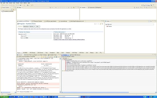

I am building my application with below packages.
However, link error is occured.
I think that utils.lib does't include function such as ti_sdo_utils_List_Object__create, ti_sdo_utils_List_Object__delete, ...
Please tell me how to resolve this problem.
CCS         : v5.2
SYS/BIOS: bios_6_33_01_25
PDK         : biospsp_03_00_01_00
IPC           : ipc_1_23_05_40
Unresolved symbol _ti_sdo_utils_List_Object__create__S in file C:/Program Files/Texas Instruments/pdk_C6748_2_0_0_0/biospsp_03_00_01_00/platforms/evm6748/vpifedc/lib/c6748-evm/674/debug/bios_psp_platform_evm6748_vpifedc.a674<CodecInterface.o674>    .xdchelp    /facedetect_evmC6748    0    C/C++ Problem
Unresolved symbol _ti_sdo_utils_List_Object__delete__S in file C:/Program Files/Texas Instruments/pdk_C6748_2_0_0_0/biospsp_03_00_01_00/platforms/evm6748/vpifedc/lib/c6748-evm/674/debug/bios_psp_platform_evm6748_vpifedc.a674<CodecInterface.o674>    .xdchelp    /facedetect_evmC6748    0    C/C++ Problem
Unresolved symbol _ti_sdo_utils_List_Params__init__S in file C:/Program Files/Texas Instruments/pdk_C6748_2_0_0_0/biospsp_03_00_01_00/platforms/evm6748/vpifedc/lib/c6748-evm/674/debug/bios_psp_platform_evm6748_vpifedc.a674<CodecInterface.o674>    .xdchelp    /facedetect_evmC6748    0    C/C++ Problem
I set  library and path in properties.
bios_psp_platform_evm6748.a674
bios_psp_i2c.a674
bios_psp_uart.a674
bios_psp_psc.a674
edma3_lld_drv.a674
edma3_lld_rm.a674
edma3_lld_drv_sample.a674
utils.lib
"${CG_TOOL_ROOT}/lib"
"${CG_TOOL_ROOT}/include"
"../../../../bin"
"C:\Program Files\Texas Instruments\pdk_C6748_2_0_0_0\biospsp_03_00_01_00\platforms\evm6748\lib\c6748-evm\674\debug"
"C:\Program Files\Texas Instruments\pdk_C6748_2_0_0_0\biospsp_03_00_01_00\platforms\evm6748\vpifedc\lib\c6748-evm\674\debug"
"C:\Program Files\Texas Instruments\pdk_C6748_2_0_0_0\biospsp_03_00_01_00\drivers\i2c\lib\c6748-evm\674\debug"
"C:\Program Files\Texas Instruments\pdk_C6748_2_0_0_0\biospsp_03_00_01_00\drivers\uart\lib\c6748-evm\674\debug"
"C:\Program Files\Texas Instruments\pdk_C6748_2_0_0_0\biospsp_03_00_01_00\drivers\vpif\lib\c6748-evm\674\debug"
"C:\Program Files\Texas Instruments\pdk_C6748_2_0_0_0\biospsp_03_00_01_00\drivers\psc\lib\c6748-evm\674\debug"
"C:\Program Files\Texas Instruments\edma3_lld_02_11_04_01\packages\ti\sdo\edma3\drv\lib\674\debug"
"C:\Program Files\Texas Instruments\edma3_lld_02_11_04_01\packages\ti\sdo\edma3\rm\lib\c6748-evm\674\debug"
"C:\Program Files\Texas Instruments\edma3_lld_02_11_04_01\packages\ti\sdo\edma3\drv\sample\lib\c6748-evm\674\debug"
"C:\Program Files\Texas Instruments\ipc_1_23_05_40\packages\ti\sdo\utils\lib\instrumented_674\utils"

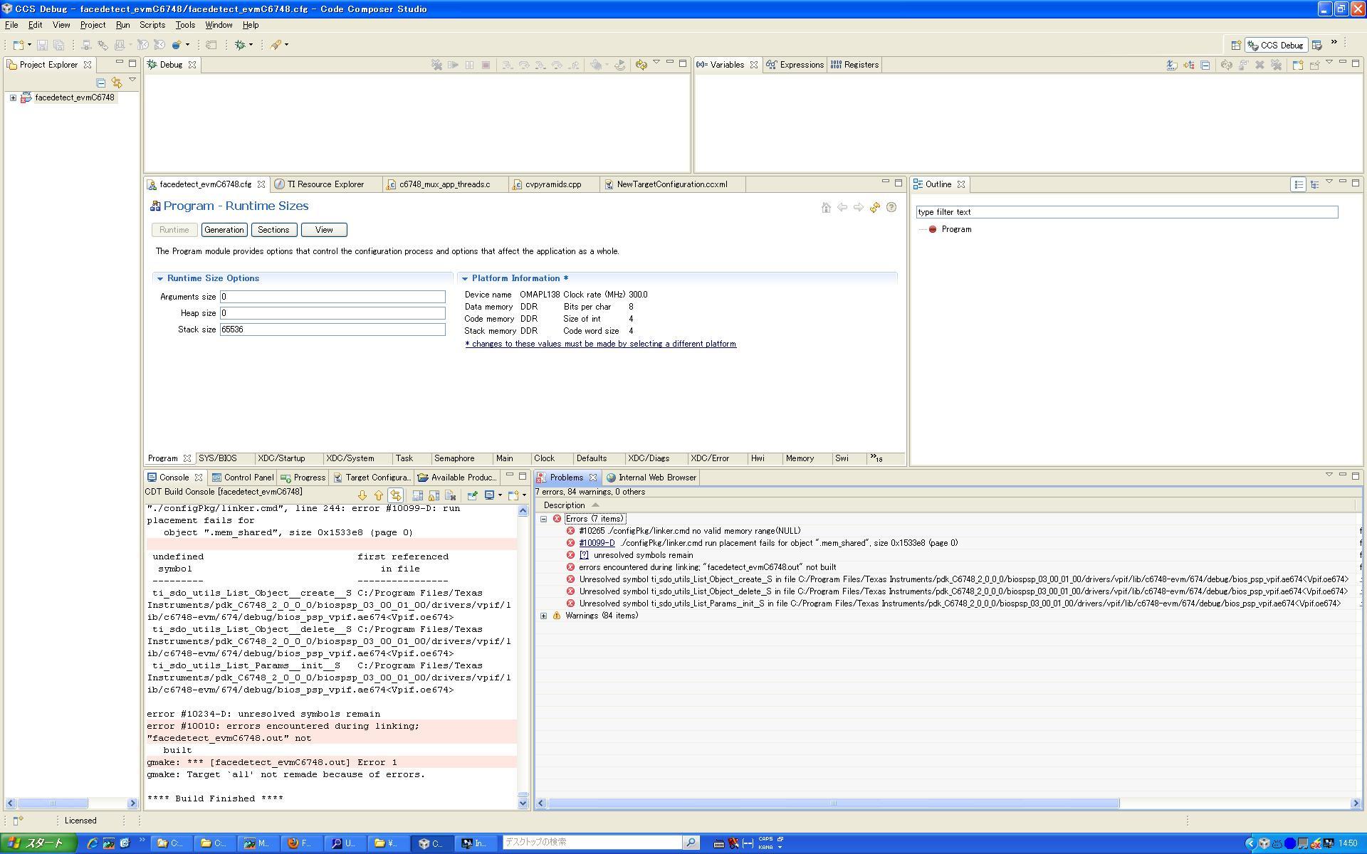

    > 3.Also send us the screen shot of the CCS Linker error to understand the error better
    please find out attached file.
    My project name is facedetect_evmC6748. this is same name of facedetect demo. don't warry.

    After looking into your CCS error, the error arises from the linking issues with the ipc libs. If the unresolved symbol issue is handled the errors #10265 and #10099 may get resolved.
    The ti_sdo_utils_List_Object__create__S is available in the C:\Program Files\Texas Instruments\ipc_1_23_05_40\packages\ti\sdo\utils\List.h. Thus kindly ensure whether the ipc_1_23_05_40\packages\ti\sdo\utils  is linked to your project properly and the List.h header file is included correctly in your project.
     Also we could see that on your first post you have used bios_psp_platform_evm6748.a674 but in the screenshots we could see you have posted bios_psp_platform_evm6748_vpifedc.ae674. Kindly see these mismatches in library too which may also take your debugging time.
