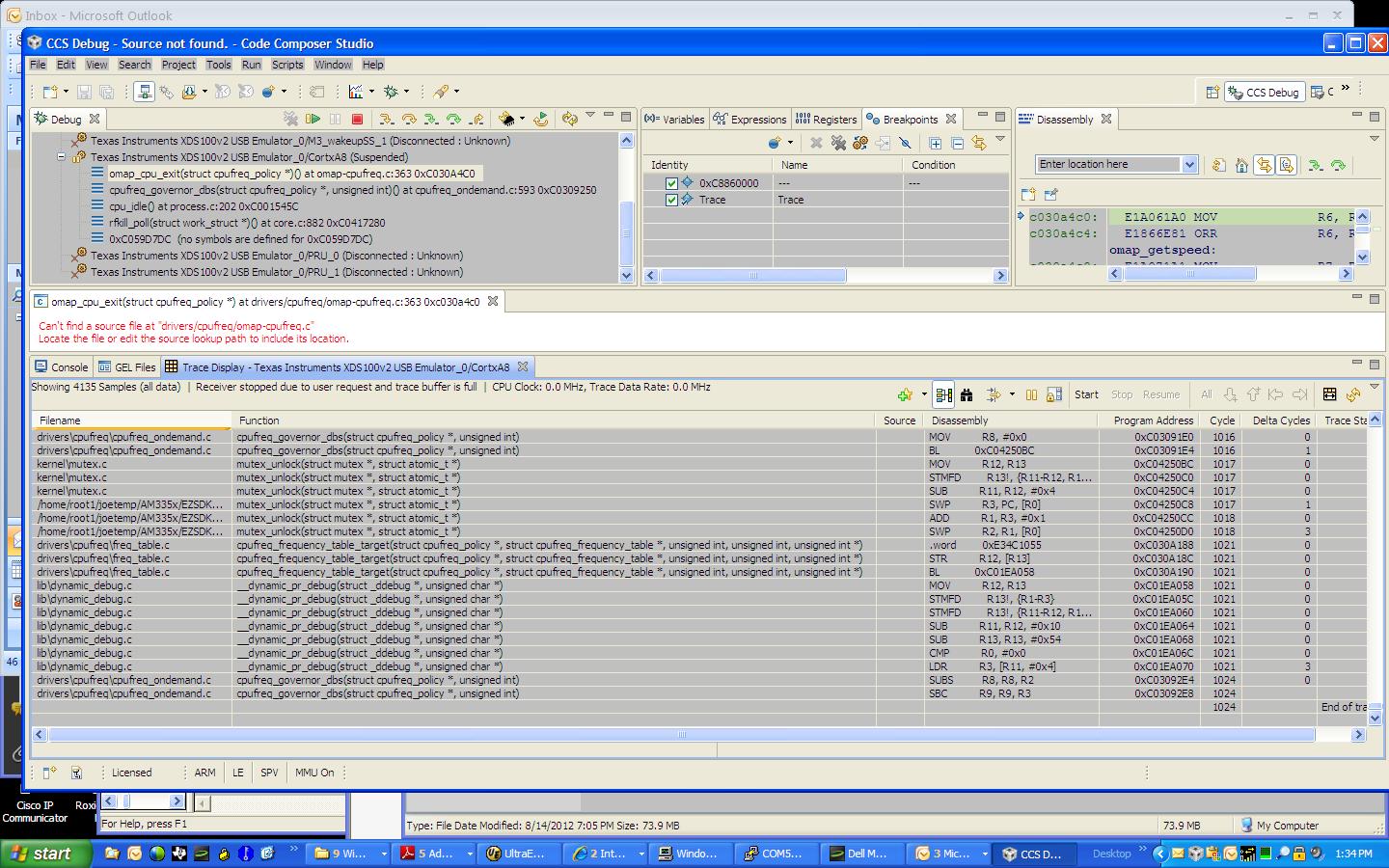

  • Proved on Beaglebone with steps in: http://processors.wiki.ti.com/index.php/AM335x_Trace
    The Enable_Trace->Enable_ETB_CortexA8_Trace() script is included in ccs5.2 and later GEL files  (AM335x_trace_dapdebugss.gel file)
    To quickly prove in WinXP Version: 5.1.0.08020 (and need vmlinux file which I copied from Linux PSP so w/o source), was able to get a trace on Beaglebone running Linux (attached screenshot).
    Just using on-board Beaglebone XDS100v2.
     Source files are listed on the left (from the vmlinux file though the files are actually present back on Linux). Function call, disassembly, program address, cycles, etc.
    all listed after that. Beaglebone Linux console window is just sitting with prompt open. Need to figure out how to trigger trace better.
    Pretty cool!
