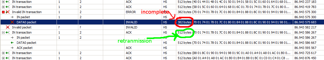

The transmission generally works but in some rare cases I don't get
the TX ready interrupt and the TXPKTRDY bit is not cleared. While
debugging the USB transmission using the usb analyzer I figured out,
that sometimes there are invalid "in transactions" (instead of 512
bytes, the packet length is shorter and a CRC error is signaled),
after an invalid transaction, I see that there is a re-transmission
(the correct packet includes the incomplete data from the invalid
transaction). After the correct re-transmission I don't get any
problems. But sometimes (while the missing TX ready interrupt) I see
that the re-transmission also fails (the packet is also not full
length). After This situation, if I reinitialize the USB module I am
able to perform a new transfers. After a while situation repeats. I
figured out, that the problem frequency is strongly related with the
system load. For example if the USB transmitted data is generated in
the DSP, the problem appears after a minute. But if there are frequent
DMA transmissions on the EMIF bus (data from external source),
the USB problem appears quickly (few seconds)
