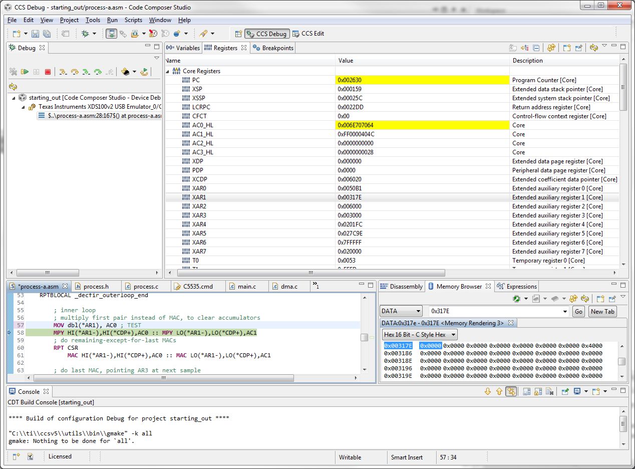

I'm using a C5535 EZUSB kit, and coding up functions for a new project I'm working on. I've run into something peculiar.
I've got a buffer in DARAM which is initialized to zero by code - and looking at it with the memory browser in CCS, it's zero. But in my assembly code, I'm reading from this buffer using AR1, and it's reading nonzero data.
Here's a screenshot (hopefully it's readable and not scaled or anything):
XAR1 points to 0x317E, which according to the memory browser, should be zero. In the code window (process-a.asm) I've just executed the "MOV dbl(*AR1), AC0" test instruction, and AC0 now contains nonzero data.
Any hints/tips/suggestions? Thanks!
  • Perhaps the CCS memory view window is addressable with 8-bit byte addresses rather than target addresses?  See if the value at (0x317e * 2) 0x62fc is 0x6e707064, as shown in AC0_HL.
  • Memory view window is word addressed as far as I can tell.
    Memory at 0x62FC (double) is 0x36A0 0x0269, memory at 0x18BF (half) is 0xF456 0x4704. Haven't found a match yet in memory for what's getting read.

  • Make sure circular addressing is disabled for XAR1 at the point of the MOV; this is configured by a bit in ST2, AR1LC.  This bit is set to 1 if circular addressing is enabled for XAR1.
  • Hmm...
    AR1LC cleared = MOV reads correct data
    AR1LC set = MOV reads garbage
    Unfortunately this is going in a filter routine where I do need circular addressing to work, so AR1LC has to be set at some point.

  • The address isn't being doubled; you are supposed to put the offset from the start of the buffer into XAR1.  If the buffer is at address 0x3000, you need to set BSA01 to 0x3000 and XAR1 to 0x60.  See Figure 6-14. Circular Buffer Computation in 23-bit page 6-114 of C55x v3.x CPU Reference Guide SWPU073E
  • THANK YOU! never realized that ARx is an offset with circular addressing mode. One asub line later, everything's working.
    Thanks again!
