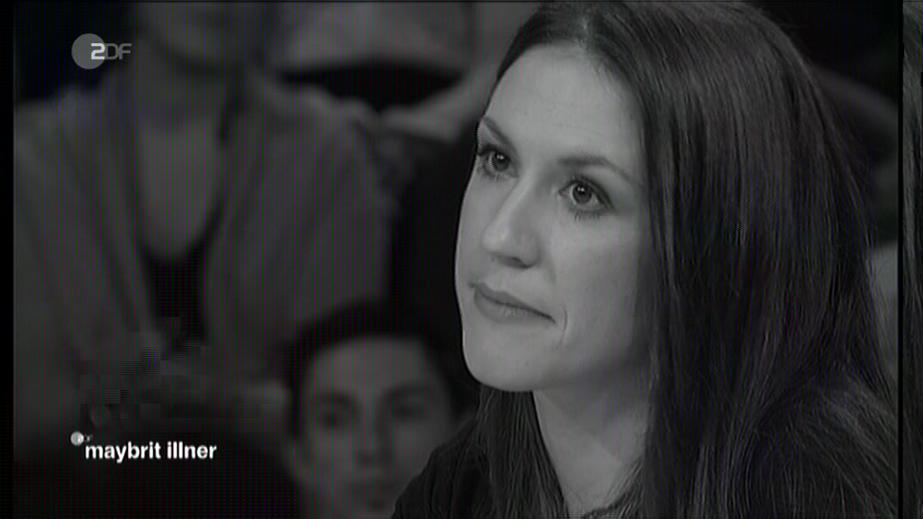

I am having a problem with my DM368 (LeopardBoard LI-TB02) and a specific mpeg2 video. As far as I can tell, mpeg2dec is not decoding it correctly (I looked at the yuv).
The video I am trying to transcode is test.m2v, the one I am getting by transcode is test.264
My gstreamer pipeline is
gst-launch -v filesrc location=test.m2v ! TIViddec2 codecName=mpeg2dec engineName=codecServer ! TIVidenc1 framerate=25/1 byteStream=false codecName=h264enc engineName=codecServer ! capsfilter caps="video/x-h264,framerate=25/1,pixel-aspect-ratio=(fraction)1777/1222" ! mp4mux ! filesink location=test.264
Is there an obvious problem with my pipeline?

    When I adjust the settings in vlc to look at the yuv-file gstreamer creates, I found out that I am able to see the video undistorted when I set the video width to 736. Not sure if this is a hardware or software issue?

    If I remember correctly, the encoder has some 32 pixels constraint where it needs the horizontal resolutions to be in multiple of 32 pixel. So either 704 or 736 will only work for you. I'm not sure about the exact reason behind it.

    Fun fact: if I play the .yuv with vlc using
    vlc --rawvid-aspect-ratio 16:9 --rawvid-fps 25 --rawvid-width 736 --rawvid-height 576 test.yuv
    I get this screenshot:
    So it looks to me (just a guess) that the buffer calculation that is invoked by the gstreamer-plugin is not accurate, while the code used by the dvtb-decoder is.

    /* DM365: TO componsate resizer 32-byte alignment, we need to set
    * lineLength to roundup on 32-byte boundry.
    So I think, the buffer gets allocated with a pixel line length of 736 and the caps gets constructed with a line length of 720. When I use the dvtb, the allocation seems to happen the same, but the yuv file created gets cropped correctly to 720 px line length, while the h264 encoder within the gstreamer pipeline gets passed a 736 px buffer but extracts the size being 720 px from the mimetype/ caps. That, from my view, explains the picture distortion seen in the posted example.
    A possible solution I see is to adjust the input buffer for the h264enc pipeline element to 736px, although I don't know if it is possible to get the output cropped back to 720px per line. From the comment I would understand that the 32px alignment is a constraint of the hardware resizer, not the hardware codec, but I guess the gstreamer-plugin-code is not the right place to look for hardware documentation.
