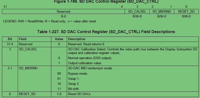

how can I power down the DM816x's video DACs?
The TRM reads:
3.2.6.3 Video DACs Power Down Control
In applications in which the Video DACs are not used at all, the power supply to the Video DACs can be
powered down by configuring the HD_DAC_CTRL and SD_DAC_CTRL registers of the Device
Configuration Registers.
But which bits in the HD_DAC_CTRL & SD_DAC_CTRL should be set?
The HD_CALSEL, HD_MIDRND and RESET_HD bit descriptions do not mention a power down state.
