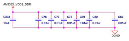

I would like to ask you about High-Speed Bypass Capacitors of AM335x.
a) There is description Datasheet Table 3-13(sprs717e: P91).
    It specifies that CVDDS_DDR is 10.06uF :
   And the capacitance on AM3358EVM is below (it is match the spec of Table 3-13):
b) On the other hand, there is description about DDR2(sprs717e: P160).
    It specifies that the total capacitance on VDDS_DDR is 10.6uF. (It is NOT 10.06uF.)
Which is correct, a) or b) ?

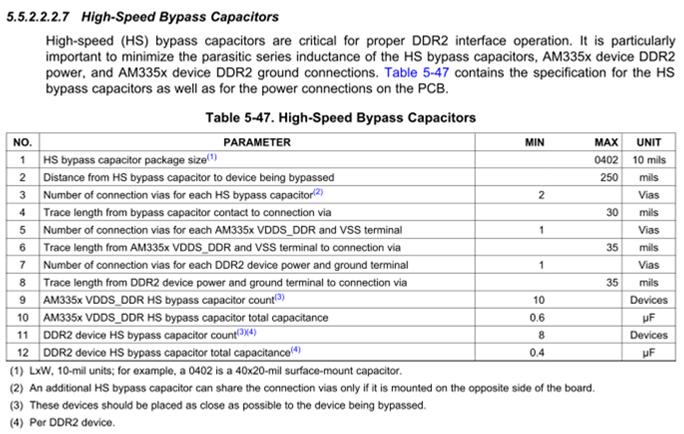

c) On table 5-47, the No.12 specifies that the total capacitance is 0.4uF.
    But, The capacitance on AM3358EVM is NOT 0.4uF. (It is total 0.08uF by 8 capacitors on EVM)
    Would you let me know the correct capacitance value?

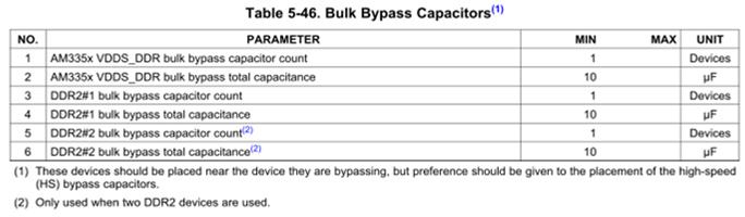

    Judging from reference designs Table 3-13 values (or rather Tables 5-46 and 5-47) are good for DDR2 designs, while Tables 5-60 and 5-61 are good for DDR3 designs. The datasheet guidelines should be followed when designing a new board.

    From AM335X Datasheet, Tables 5-46 and 5-47:
    AM335x VDDS_DDR: 1x10uF + 0.6uF (minimum 10 HS capacitors)
    For each DDR2 memory: 1x10uF + 0.4uF (minimum 8 HS capacitors)

  • Hi RY,
    In my opinion Table 5-46 and Table 5-47 should take precedence. I base this on Note (4) after Table 3-13.

  • We only specify the typical capacitance so customers have some flexibility in their system design.  It is much more important to optimize high-frequency capacitor placement and connections to AM335x power terminals than total capacitance.
    For example, the data sheet recommends a typical value of 10.08 uF for VDD_CORE, with a note describing how the 10.08 uF is a combination of one 10 uF bulk capacitor and eight high-frequency 10 nF capacitors.  The goal would be to place all of these capacitors as close as possible to the AM335x VDD_CORE terminals.  It is very important to place the high-frequency capacitors under the BGA area of the PCB to minimize inductance and loop area of their connections to the AM335x power terminals, but this is not as important for the bulk capacitors.  In most case there may not be enough room to place all eight of the high-frequency capacitors under the BGA without compromising the number of high-frequency capacitors connected to other power rails.
    The typical capacitor values recommended in the data sheet provide a starting point when beginning a product design.

  • We plan to remove the typical capacitance value and the reference to note (3) for the CVDDS_DDR parameter in Table 3-13  .  Note (4) will be used to reference the respective DDR section for capacitor recommendations.
    The capacitor recommendations in the respective DDR section are listed as minimums and not specific requirements.  For example, in Table 5-47 shows a minimum of 10 high frequency capacitors for AM335x VDDS_DDR with a minimum of 0.6uF capacitance.  In this case it would be best to use 10 - 0.1uF capacitors since 60nF capacitors are not a common value.
    As mentioned in my previous email, the number of capacitors used is not as important as the placement and low impedance connections of the capacitors.

  • I did not performed the analysis that derived the capacitor recommendations published in the data sheet.  Therefore, I can not provide any firm recommendation other than what is published in the respective DDR section of the data sheet.
    If they must make a choice between placing larger capacitors around the BGA perimeter rather than placing the smaller capacitors under the BGA, I recommend they place as many small capacitors as possible under the BGA and also place the remaining large capacitors around the perimeter.  This seems like a reasonable compromise.
