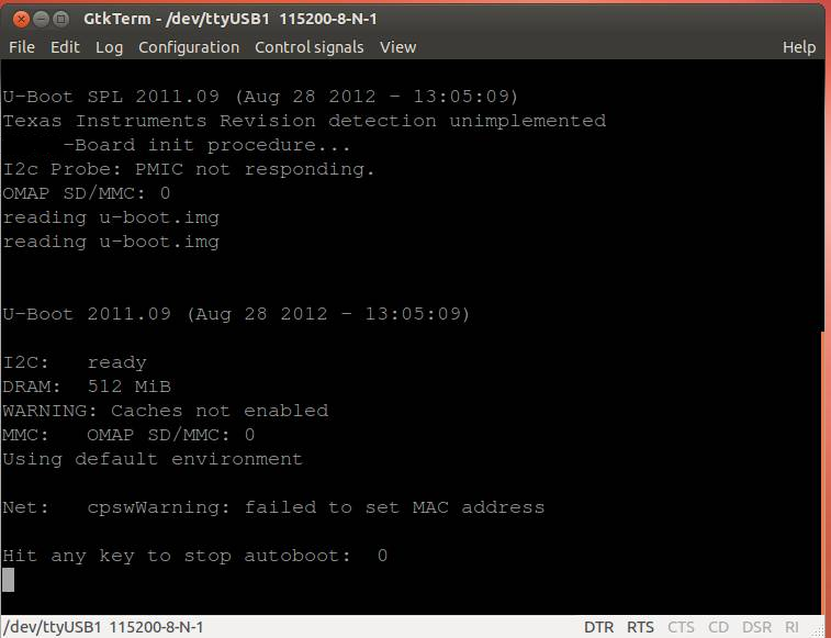

Good day,
have a problem and was hopping for some help.
We made a custom board based on the XAM3359ZCZ processor and produced few prototypes that were running flawlessly and they are still. Now, the problem started when we ordered the first larger batch with the official AM3359 processor. Inserted the microSD card and was hoping to see a clean boot, but as it turned out the original u-boot/Kernel are not booting (used the same card as with the prototypes). The only major hardware change was switching to a production level microprocessor, since the former was still labeled as X. Went throught almost the whole batch and majority stopped at the same time, just before the kernel image would be read. Tested them also with the CodeComposer's GEL scripts for DDR2 (Quick Test) and it went throught with no errors (on 266MHz). Where on the first prototypes we needed to lower the frequency to 200MHz for a successfull test with CCS, but with the u-boot/kernel the 266MHz setting worked fine.
Here is the original u-boot output (attached image):
and here is the output tested with a newer u-boot, with some additional printfs:

Mind the two different outputs (second one with the baudrate error). Could this be the frequency related issue, because with the newer u-boot a colleague of mine set the processor's frequency to 500MHz? He had to lower it to 500MHz just to be able to cancel the autoboot and get into u-boot's shell.

  • If you're having to underclock it to get uboot stable, there's something wrong with your ram timings/who knows what else.
    Use the jtag and step through the uboot code as it comes up..
    Apperantly DDR is working fine, since we've tested it with the CCS and later also with a "customized" u-boot that directly calls/tests the DDR without putting in the "mtest" command. But if we manually run the mtest command in prompt, we get errors.

    We actually found the problem/solution and it was, as always, right in front of us. In the end, it was as Charles suggested. The problem was with DDR timings. We've downloaded those excel tables and inserted the outcome numbers in u-boot. Had to tweak them some more to work at max frequency, but in the end it worked.
    With added printf's in the code as we were trying to find the problem, we just delayed the memory reading/writing bursts and thus the error was not always at the same time.
