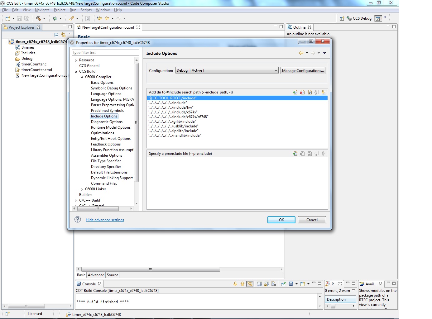

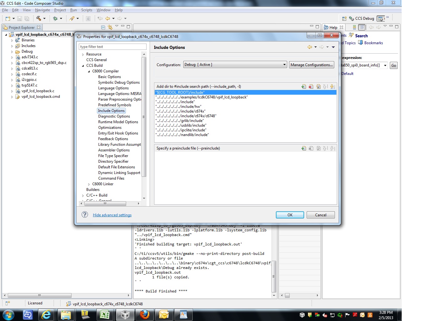

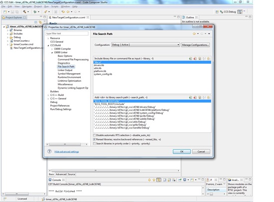

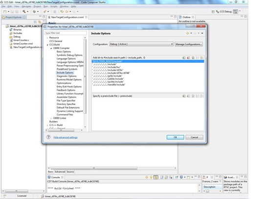

  • Hi PP,
                You have specified that you are using C6748_LCDK but the error you are facing talks about evmC6748_bsl.lib? In your Target Configuration, make sure that C6748_LCDK have the "initialization script" set to ..\..\emulation\boards\lcdkc6748\gel\C6748_LCDK.gel. You can find these when the Target Configuration window is open and you click on the Advanced tab (bottom of window) then click on the C674X_0.
    Also,kindly ensure whether the linker include options in CCS properties tab is including the libraries as shown below
    Iyshwarya
    If this answers your question, please click the Verify Answer button below. If not, please reply back with more information.
