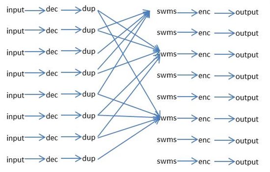

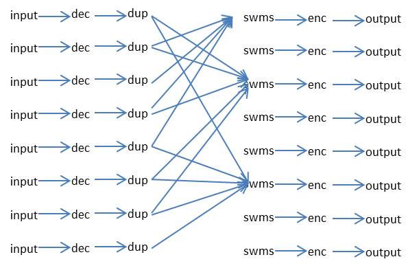

  •  Hi Badri,
    Actually we want to set up a media server of video conference. The following picture describes our data flow. Each swms instance would take some decoded video streams as its input and generate a specific output. This is because in the video conference each participant should be able to choose the other participants' pictures which he want to see. The input video size is under D1, so I think the hw capability is enough. And in EZSDK we can create more than 8 swms instances. So, if the limitation on swms instance is sw limitation, how could I increase it?
    Thanks so much!
  • I don't see any picture but I understand you want to compose and encode instead of display. To increase number of swms instances modify

  • I think your data flow would be :
    IpcBitsOutHLOS -> IpcBitsInRTOS -> decLink -> ipcOutM3 -> ipcInM3 -> Merge -> Dup -> SwMs 0 - 7 -> Merge -> Nsf -> ipcOutM3 -> ipcInM3 -> encLink -> ipcBitsOutRTOS -> ipcBitsInHLOS
    SwMs itself can be configured to map input channel to output window so you don't need selectlink.
    You will have to modify dupLink to support 8 output queues and merge link to support  input queues.You have to modify

  • Yes, the data flow is exactly what I need. I think the first merge before dup could be removed. So, I need to write a usecase to realize the data flow and create a new demo. Then, how could I make the usecase? I mean how to write or modify the *.MK files.
  • Yes merge before dup is not needed. Refer exisiting usecase like VSYS_USECASE_MULTICHN_HYBRID_DVR_16CH

    [m3vpss ] 49649: SWMS : ******* Configuring clock 30 secs...
    [m3vpss ] 49649: SWMS2 : Loading Vertical Co-effs (UPSCALE)x ...
    [m3vpss ] 49649: SWMS2 : Loading Horizontal Co-effs (UPSCALE)x ...
    [m3vpss ] 49649: SWMS : Co-effs Loading ... DONE !!!
    [m3vpss ] 0 | 0 | 0, 0 | 320 x 240 | 512 / 512 | NON-TILED | 0, 0 | 512 x 360 | 2560 / 0 | NON-TILED | OFF | 0 | 420SP | OFF |
    [m3vpss ] 1 | 1 | 0, 0 | 320 x 240 | 512 / 512 | NON-TILED | 512, 0 | 512 x 360 | 2560 / 0 | NON-TILED | OFF | 0 | 420SP | OFF |
    [m3vpss ] 2 | 2 | 0, 0 | 320 x 240 | 512 / 512 | NON-TILED | 0, 360 | 512 x 360 | 2560 / 0 | NON-TILED | OFF | 0 | 420SP | OFF |
    [m3vpss ] 3 | 3 | 0, 0 | 320 x 240 | 512 / 512 | NON-TILED | 512, 360 | 512 x 360 | 2560 / 0 | NON-TILED | OFF | 0 | 420SP | OFF |
    [m3vpss ] 4 | 4 | 0, 0 | 320 x 240 | 512 / 512 | NON-TILED | 1024, 0 | 256 x 180 | 2560 / 0 | NON-TILED | OFF | 0 | 420SP | OFF |
    [m3vpss ] 5 | 5 | 0, 0 | 320 x 240 | 512 / 512 | NON-TILED | 1024, 180 | 256 x 180 | 2560 / 0 | NON-TILED | OFF | 0 | 420SP | OFF |
    [m3vpss ] 6 | 6 | 0, 0 | 320 x 240 | 512 / 512 | NON-TILED | 1024, 360 | 256 x 180 | 2560 / 0 | NON-TILED | OFF | 0 | 420SP | OFF |
    [m3vpss ] 7 | 7 | 0, 0 | 320 x 240 | 512 / 512 | NON-TILED | 1024, 540 | 256 x 180 | 2560 / 0 | NON-TILED | OFF | 0 | 420SP | OFF |
    [m3vpss ]
    [m3vpss ] SWMS:HEAPID:0 USED:360
    [m3vpss ] SWMS:HEAPID:1 USED:43776
    [m3vpss ] SWMS:HEAPID:4 USED:7372800
    [m3vpss ] 49653: SWMS: Create Done !!!
    [m3vpss ] 49653: SWMS: Create in progress !!!
    [m3vpss ] 49694: Assertion @ Line: 148 in links_m3vpss/swMs/swMsLink_drv.c: status==FVID2_SOK : failed !!!
  • I set the swMsPrm[i].enableLayoutGridDraw = FALSE, and the error of creating DMA Channel for the third swms instance disappears. But another error happens when calling the function SwMsLink_drvCreateScDrv. The following is the new error message.
    [m3vpss ] 30975: SWMS : ******* Configuring clock 30 secs...
    [m3vpss ] 30975: SWMS2 : Loading Vertical Co-effs (UPSCALE)x ...
    [m3vpss ] 30975: SWMS2 : Loading Horizontal Co-effs (UPSCALE)x ...
    [m3vpss ] 30975: SWMS : Co-effs Loading ... DONE !!!
    [m3vpss ]
    [m3vpss ] *** [SWMS2] Mosaic Parameters ***
    [m3vpss ]
    [m3vpss ] Output FPS: 30
    [m3vpss ]
    [m3vpss ] Win | Ch | Input | Input | Input | Input | Output | Output | Output | Output | Low Cost | SWMS | Data | Blank |
    [m3vpss ] Num | Num | Start X, Y | Width x Height | Pitch Y / C | Memory Type | Start X, Y | Width x Height | Pitch Y / C | Memory Type | ON / OFF | Inst | Format| Frame |
    [m3vpss ] ----------------------------------------------------------------------------------------------------------------------------------------------------------------------
    [m3vpss ]
    [m3vpss ] SWMS:HEAPID:0 USED:224
    [m3vpss ] 30979: SWMS: Create Done !!!
    [m3vpss ] 30979: SWMS: Create in progress !!!
    [m3vpss ] UTILS: DMA: Allocated CH (TCC) = 61 (61)
    [m3vpss ] UTILS: DMA: 0 of 1: Allocated PaRAM = 61 (0x490047A0)
    [m3vpss ] SWMS: instance 0, sc id 5, start win 0 end win 17
    [m3vpss ] 31024: Assertion @ Line: 2329 in links_m3vpss/swMs/swMsLink_drv.c: pDrvObj->fvidHandle != NULL : failed !!!
  • You are using SC 5 for all the scalers. You have to use additional scaler instances as there is a limit to number of channels that can be opened with a single scaler resource.Pls refer multich_vdec_vdis.c for example of multiple scaler usage in swms. Assign different scaler instances to different swms
  • Thanks for your kindly reply! I find 8 different scalar instances:
     #define SYSTEM_SW_MS_SC_INST_DEIHQ_SC (1)
     #define SYSTEM_SW_MS_SC_INST_DEI_SC (2)
     #define SYSTEM_SW_MS_SC_INST_VIP0_SC (3)
     #define SYSTEM_SW_MS_SC_INST_VIP1_SC (4)
     #define SYSTEM_SW_MS_SC_INST_SC5 (5)
     #define SYSTEM_SW_MS_SC_INST_DEIHQ_SC_NO_DEI (6)
     #define SYSTEM_SW_MS_SC_INST_DEI_SC_NO_DEI (7)
    I find that the SYSTEM_SW_MS_SC_INST_SC5 could be set for two swms instance. Could I use the 3-6?
  • Now the error happens when creating the 4th swms instance. I think there is still lack of some resources.
    [m3vpss ] SWMS:HEAPID:1 USED:15840
    [m3vpss ] 48789: SWMS: Create Done !!!
    [m3vpss ] 48789: SWMS: Create in progress !!!
    [m3vpss ] UTILS: DMA: Allocated CH (TCC) = 62 (62)
    [m3vpss ] UTILS: DMA: 0 of 1: Allocated PaRAM = 62 (0x490047C0)
    [m3vpss ] SWMS: instance 0, sc id 3, start win 0 end win 17
    [m3vpss ] 48837: Assertion @ Line: 2329 in links_m3vpss/swMs/swMsLink_drv.c: pDrvObj->fvidHandle != NULL : failed !!!
  • You cannot use VIP0_SC if you use SC5 due to HDVPSS resource conflict.
    Pls use the following scalers
    Make sure you set correct values for start win and endWin for each scaler instance
  • Hi Badri,
    I use
    SYSTEM_SW_MS_SC_INST_SC5,
    SYSTEM_SW_MS_SC_INST_VIP1_SC,
    SYSTEM_SW_MS_SC_INST_DEI_SC_NO_DEI,
    as the swms scaler instance. Now the error appears at the function Utils_dmaCreateCh(). The error message shows that the DMA channel Id is upto 63 already. And I find in file \DVRRDK_03.50.00.05\dvr_rdk\mcfw\src_bios6\utils\src\utils_dma_common_cfg.c that the "Total number of DMA Channels supported by the EDMA3 Controller" is 64. So, I wonder if the limitation of number of DMA channels lead to this fail when calling  Utils_dmaCreateCh(). The following is part of the log, and you could see the DMA channel number.

  • Pls try commenting out call to SwMsLink_drvDmaCreate & SwMsLink_drvDmaDelete. make sure createArgs.enableLayoutGridDraw for swmsPrms. Also disable the code in swms to do outBufCopy.
    To disable outBufCopy modify SwmsLink_drv.c .
    after check for isInputReceived force isInputReceived = TRUE.
  • Sorry, I don't quite understand. There are two variables named copyInBuf2OutBuf and copyOutBuf2OutBuf. Should I set both of them to FALSE? And "isInputReceived" appears many times in the file  SwmsLink_drv.c.Should I set all of them to FALSE?
  • Ok looks like you are using RDK 3.5. You just have to set swmsPrm.outBufModified = TRUE in your usecase file
  • Then what I should do is below:
    1. comment the  SwMsLink_drvDmaCreate & SwMsLink_drvDmaDelete in SwmsLink_drv.c
    2. set swmsPrm.outBufModified = TRUE
    Is that right?
  • Hi Badri,
    It still fails when creating the 6th swms instance. I do some test, and it seems that SYSTEM_SW_MS_SC_INST_DEIHQ_SC, SYSTEM_SW_MS_SC_INST_DEI_SC and  SYSTEM_SW_MS_SC_INST_VIP0_SC could not be used to set swMsPrm.swMsInstId[0]. SYSTEM_SW_MS_SC_INST_SC5 and SYSTEM_SW_MS_SC_INST_VIP1_SC each could be used to set for 2 swms instances. The other two each could be set for 1 swms instance. So, the scalar instances is not enough.
    Then how to  solve problem?
  • Can you change SYSTEM_SW_MS_MAX_WIN_PER_SC to 8 in swmsLink_priv.h and try as you require only max 8 windows
  • Hi Badri,
    I set SYSTEM_SW_MS_MAX_WIN_PER_SC to 8 but nothing changed. And I found that for the first 6 swms instances, all these 7 scalar instances could be set as swmsPrm.swMsInstId[0]. But for the 7th swms instances all of them will get the same error when creating fvidHandle.
    I just don't know how to resolve this issue. So, I really need your help to carry on.
    Thanks so much!
  • You can use only 3 scalers:
    Make the change to set swms max win as 8 and assign the scalers as 3 SwMs instance ,3 SwMs instance ,2 SwMs instance.
    Pls share the  console logs, your app changes and your changes to swms after doing the mentioned changes.
  • Ok, I will have a try and tell you the result.
  • Hi Badri,
    Sorry to tell you that nothing changes.
    Now I set swms max win to 8 and use the above three scalars as you said. But the same error happens when creating the 7th swms instance. I attach the log file in the end. And if you need I could offer the demo file and usecase file too.
    2818.M3log.txt
  • We have tried with 4 scalers and it has worked.
    NOt sure why you are facing the issue.Anyhow you can use 2 scaler instances with 4 swms inst each.
  • Do you mean I can use two of them and each could be set to 4 swms instances?
  • I tried to use SYSTEM_SW_MS_SC_INST_DEIHQ_SC_NO_DEI and SYSTEM_SW_MS_SC_INST_VIP1_SC, set each of them to 4 swms instances as scalar instance. It does not work.
    Do I misunderstand what you mean?
  • For the swms link, I just modified the following 3 places in the swMsLink.h and swMsLink_priv.h:
    #define SW_MS_LINK_OBJ_MAX              (8) //4
    #define SYSTEM_SW_MS_MAX_INST                (8)//4
    #define SYSTEM_SW_MS_MAX_WIN_PER_SC      (8)//18
  • Hi Badri,
    I forget something. In addition to the above three changes, I also comment the SwMsLink_drvDmaCreate() and SwMsLink_drvDmaDelete() functions in swMsLink_drv.c. And set the swms.outputBufModified = TRUE followed your advice.
    In addition, I try to just use 6 swms instances(use 6 input files) to test the whole data flow. The app runs with no error, but the output h264 file has no data. It seems the enc instance does not receive any input data.
    Sorry to trouble you so much, but I  really need your help. Thanks so much!
