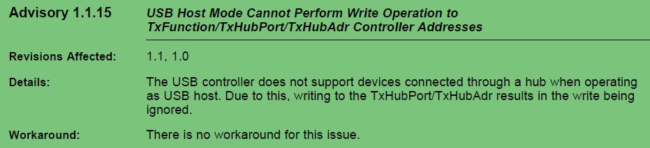

The USB Interface of the Extension can not work
I use the USB Interface of the Extension on my custom board by the USB externsion chip of GL850G-28,when I use insert USB disk, I can mount the usb on /mnt of filesystem. But, when I try to read or write on the usb, the fail appear as follow:

usb 1-1: new high speed USB device using musb-hdrc and address 2

usb 1-1: device descriptor read/64, error -71
ata2: SATA link down (SStatus 0 SControl 300)
usb 1-1: new high speed USB device using musb-hdrc and address 3
davinci_mdio davinci_mdio.0: resetting idled controller
net eth0: attached PHY driver [Generic PHY] (mii_bus:phy_addr=0:01, id=282f014) davinci_emac.c
usb 1-1: new high speed USB device using musb-hdrc and address 4
usb 1-1: device not accepting address 4, error -71
IP-Config: Complete:
     device=eth0, addr=192.168.26.122, mask=255.255.0.0, gw=192.168.26.1,
     host=virtul-box, domain=, nis-domain=(none),
     bootserver=192.168.26.26, rootserver=192.168.26.26, rootpath=
Waiting 4sec before mounting root device...
usb 1-1: new high speed USB device using musb-hdrc and address 5
usb 1-1: device not accepting address 5, error -71
hub 1-0:1.0: unable to enumerate USB device on port 1

Also,my custom board have the other USB interface which is the same as EVM board,and that  USB can read and wirte normally. I'm wonder that if should add GL850G-28 driver into kernel, But I can not get this dirver from the Internet. How can I to solve the problem?
