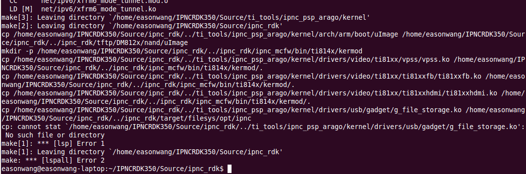

If I change the option in Rules.make from ipnc to evm, when compile it will report that can not find the defconfig file 'ti8148evm_ubifs_defconfig'
I checked this and find that there is no such file. If I use ti8148evm_defconfig instead, I find it has turn off the SPI.
If I copy this defconfig file from DVRRDK, the compilation will fail for .ko failure, after uImage has been generated, so it will not affect the binary.
Could you help check if I am following the right way to configure/compile?

  • One thing to confirm:
    Errors about the ko files show up after the uImage has been generated, so there shoud be no risk of using the uImage, right?
    Is is nessesary to clear all the errors? I just want to test SPI driver on EVM with the kernel .
    If I want to clear the error, do I just need to compare the defconfig file from DVRRDK w/ the one exist in IPNCRDK kernel folder?

  • Below is the error log:
