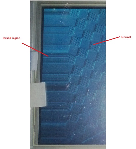

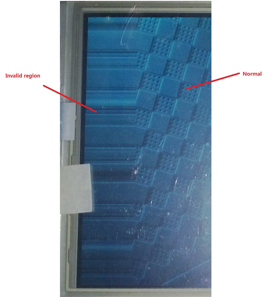

    I use CAPTURE+DISPLAY usecase to test our FPGA decoder, the input image format is yuv4:2:2, 16bits, discreate sync and connected to VIP1.
    Now, I can get the image and display to LCD, But the image is not correct, the left side image region is not normal.
    2. I use  GT_0trace to output message, but I can't found the message in the console terminal, How active
    this function for debug VPSS.
  • The image sample in here
  • For the print pls use Vps_printf to get the debug prints on console.
    What is the input and output resolution? Are you using any other modules in the VIP? Can you first dump the frame from the capture and check if it is correct? If it is not correct, FPGA is not providing correct data. Also which discrete sync input mode you are using? ie vsync/hsync or vsync/actvid. In the case of vsync/hsync mode, it will capture h blanking data as well. Have you cropped blanking data from the input frame?
    1. Our image device output resolution is 1600 x 1200, ycrcr4:2:2, 16bits, hsync and vsync
    1. Only one module(FPGA) connected to VIP1, VIP0 is not use.
    1. Is your mean dump the caputure yuv data? But I don't know how do it
    2. I am sure FPGA output data is correct, I can use V4L2(ezsdk_5_05_01_04_dm814x) to test FPGA decoder successfully.
    1. I don't understand your mean, please tell me the detail.
    2. How to cropped blanking data from the input frame?

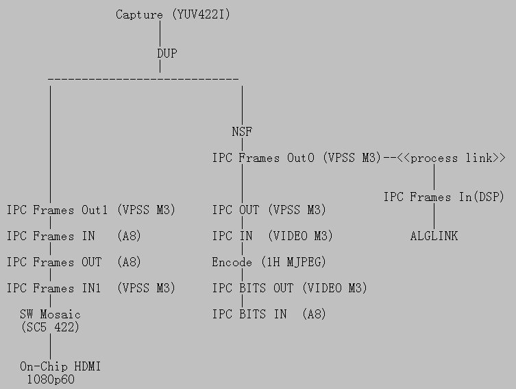

    My usecase flowchart
    Capture (YUV422I) 1CH (1600x1200) 15fps
                  NSF (YUV420SP)
                       SW Mosaic
                     (SC5 YUV422I)
                  LCD (800x600)
  • Hi Brijesh
    I doubt VIP capture timing config is not correct,  then  I modified hFrontPorch and hBackPorch value in struct FVID2_ModeInfo ,
    However I can't got the good result.
    I look forward to see TI expert reply
  • Hi Steven,
    in hsync style of capture, VIP captures complete line including horizontal blanking portion of the image, You will have to crop this blanking portion either using VIP trimmer or trimmer of the scalar. If you see capture statistics says that input frame size is 1920x1200, but you are trying to capture frames of size 1600x1200. So it is capturing 320 pixels extra, which has to be trimmer off.
    You can configure VIP trimmer using ioctl IOCTL_VPS_CAPT_SET_VIP_CROP_CFG. I think this ioctl is not supported in capture link, you will have to add it in the capture link.

  • Hi Brijesh
    I have some quetion about below usecase flowchart.
                                              Capture (YUV422I)
                                              NSF (YUV420SP)
                                          IPC Frames Out  (VPSS M3) ------------------<<<processLink>>>-----------
                                           IPC Frames IN   (A8)                                                                           FramesInDSP
                                          IPC Frames OUT  (A8)                                                                           ALG LINK (Our ALG)
                                           IPC Frames IN (VPSS M3)
                                               SW Mosaic
                                                (SC5 422)
                                           On-Chip HDMI
    My question as below.
    Q1. I want to snapshot a yuv frame, and then load VIDEO M3 encode to a jpeg file, how to do this work?
    Q2. Currently, I don't want to encode video, only want to snapshot jpeg file and display video, can you give me a work usecase?
    I did not get exactly the question. From where do you want to get the snapshot? Do you want to capture frame which is getting displayed?
    Brijesh Jadav
  • Hi Brijesh
    Sorry, I don't say clearly.
    I want to do three works
    1. Capture video and display on the LCD.
    2. Snapshot a jpeg file and save local.
    3.Can link to our ALG for image analysis.
    Now, I can display capture video on the LCD, but I don't know how to snapshot a jpeg file.
    Can you giev a work usecase flowchart?
  • For JPEG snapshot you data flow should be
    Capture -->NSF --> Dup --> IpcOutM3 --> IpcInM3 --> encLink --> ipcBitsOutRTOS --> ipcBitsInHLOS
                                           --> ipcFramesOut --> ipcFramesInHLOS --> SwmS --> Display
    Create a MJPEG channel in encLink and set the targetFPS to zero so that by default it will not encode.
    When you require snapshot invoke the ENC_LINK_CMD_SET_CODEC_SNAPSHOT cmd and you will receive the encoded MJPEG frame from Venc_getBitstreamBuffer call.
    Also can you explain why do you send the frame to A8 in your current data flow ?
  • Hi Badri
    Sorry for late.
    1. I send the frame to A8 for convenient test capture video.  in that data flow , I can capture yuv frame and yuv video file successfully.
        I found a function Enclink_jpegEncodeFrame in encLink_jpeg.c ,  my begining thinking is when I got the yuv frame,  and then
       invoke Enclink_jpegEncodeFrame encode to jpeg frame. But I don't know whether can work.
    2. I have a question about your data flow.
    Q1: How to connect directly from ipcBitsInHLOS to ipcFramesOut?  may be require decLink .
           if can connect , would you give me some code?
    3.  currently,  my usecase as below
    The left chain is woork, can see the image on the device, but the right chain can't receive the frame information.

  • Hi Badri
    I have another question for snapshot jpeg frame.
    Send this command ENC_LINK_CMD_SET_CODEC_SNAPSHOT will invoke below function
    Int32 EncLink_codecForceDumpFrame(EncLink_Obj * pObj,
    EncLink_ChannelInfo * params)
    Int32 status = ENC_LINK_S_SUCCESS;
    EncLink_ChObj *pChObj;
    UInt key;
    key = Hwi_disable();
    pChObj = &pObj->chObj[params->chId];
    pChObj->forceDumpFrame = TRUE;
    Hwi_restore(key);
    return (status);
    This function only set pChObj->forceDumpFrame = TRUE, this variable can see use in function EncLink_codecQueueFramesToChQue
    static Int32 EncLink_codecQueueFramesToChQue(EncLink_Obj * pObj)
    UInt32 frameId, freeFrameNum;
    FVID2_Frame *pFrame;
    System_LinkInQueParams *pInQueParams;
    FVID2_FrameList frameList;
    Int32 status;
    UInt32 curTime;
    Bool skipFrame;
    pInQueParams = &pObj->createArgs.inQueParams;
    System_getLinksFullFrames(pInQueParams->prevLinkId,
    pInQueParams->prevLinkQueId, &frameList);
    if (frameList.numFrames)
    pObj->inFrameGetCount += frameList.numFrames;
    freeFrameNum = 0;
    curTime = Utils_getCurTimeInMsec();
    for (frameId = 0; frameId < frameList.numFrames; frameId++)
    pFrame = frameList.frames[frameId];
    pChObj = &pObj->chObj[pFrame->channelNum];
    pChObj->inFrameRecvCount++;
    if (( FALSE == pChObj->algObj.algCreateParams.singleBuf) ||
    (pObj->inQueInfo.chInfo[pFrame->channelNum].scanFormat ==
    FVID2_SF_PROGRESSIVE))
    pChObj->nextFid = pFrame->fid;
    skipFrame = FALSE;
    if(pChObj->forceDumpFrame == FALSE)
    skipFrame = EncLink_doSkipFrame(pChObj, pFrame->channelNum);
    if (pChObj->forceAvoidSkipFrame == TRUE)
    skipFrame = FALSE;
    else
    pChObj->forceDumpFrame = FALSE;
    pChObj->curFrameNum++;
    /* frame skipped due to user setting */
    if(skipFrame || pChObj->disableChn)

    xu steven said:
    currently,  my usecase as below The left chain is woork, can see the image on the device, but the right chain can't receive the frame information.
    Pls share the usecase file and log of Vsys_printBufferStatistics. Make sure you are doing System_linkStart for all links that you are creating.Looks like the link after NSF is not freeing back the buffers. This can be problem with link connection between nsfLink and nextLink.
    xu steven said:
    the snapshot jpeg frame principle or flowchart?
    MJPEG encoder in generally configured for low fps like 1 fps . This means if input is 30 fps, it will drop 29 frames and encode only 1 frame .When the SNAPSHOT CMD is sent, it will encode the next frame received disregarding the fps .The snapshot image can be got by the application by doing Venc_getBitsteamBuffer and checking if the received frame corresponds to MJPEG channel
  • HI Badri
    The right chain is work, the reason is like you memtion.
    Now, I have no any question.
    Thanks & Regards

    I have a issue need your help, mention as below.
    I am able to capture video and display on the LCD, but the color isn't corrent, the red color
    is look like blue
    I capture the video frame and save file to A8 host and open the file to display, I found the
    picture is normal, the color is correct. so i am sure the problems on the display setting.
    My display device is LCD and pipeline to DVO2 ,  config as below.
    configure_lcd()
    echo "Configuring fb0 to LCD"
    echo 0 > /sys/devices/platform/vpss/graphics0/enabled
    echo 0 > /sys/devices/platform/vpss/display1/enabled
    echo 33500,800/164/89/10,600/10/23/10,1 > /sys/devices/platform/vpss/display1/timings
    echo triplediscrete,rgb888 > /sys/devices/platform/vpss/display1/output
    echo 1 > /sys/devices/platform/vpss/display1/enabled
    echo 1:dvo2 > /sys/devices/platform/vpss/graphics0/nodes
    echo 1 > /sys/devices/platform/vpss/graphics0/enabled
    fbset -xres 800 -yres 600 -vxres 800 -vyres 600
    fbset -depth 32 -rgba 8/16,8/8,8/0,0/0
    My display parameter setting is below
    vdisParams.deviceParams[VDIS_DEV_HDMI].resolution = VSYS_STD_SVGA_60;
    vdisParams.deviceParams[VDIS_DEV_HDMI].outputInfo.dataFormat = SYSTEM_DF_RGB24_888;
    vdisParams.deviceParams[VDIS_DEV_DVO2].resolution = VSYS_STD_SVGA_60;
    vdisParams.deviceParams[VDIS_DEV_DVO2].outputInfo.dataFormat = SYSTEM_DF_RGB24_888;
    Q1: why the video color is not correct?
    Q2: I notice that the dataFormat is support
    Hi Brijesh
    is look like blue.
    configure_lcd()
    Q2: I notice that the dataFormat is support FVID2_DF_RGB24_888, FVID2_DF_YUV420SP_UV and  FVID2_DF_YUV422,
         not support FVID2_DF_ARGB32_8888 , My be FVID2_DF_ARGB32_8888 is right.
    Thanks and Regards

  • Hi Brijesh,
    I hope you can assist me with the following.
    I manage successfuly to show NTSC captured video on our  1024x768 60P display.
    Now, I only try to do the same with PAL input instead.
    I already see that the PAL video is captured successfuly.
    But on trying to display it I get that part of the screen has some noise (as you can see in below image).
    Is it a timing issue with LCD ? (I think the timing already works successfuly if ntsc inoput has no issues, so probably ity is something else)
    If you can only point me to dome direction it is good enough.
    Thank you for any hint,
    Ran
