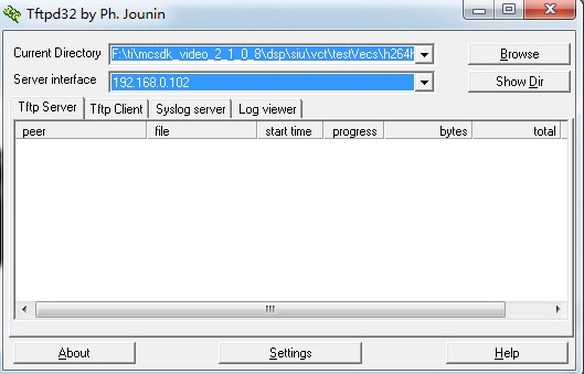

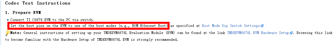

1. I choose the mode as no boot(or IBL TFTP):
2. IP set as shown:
3. tftp32d  set as shown:
I don't know why it report error.
could you help me?

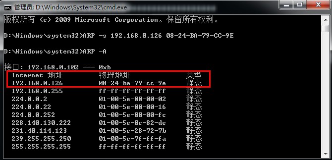

  • Hi Lei,

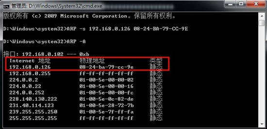

    Did you add the arp entry as described @ http://processors.wiki.ti.com/index.php/MCSDK_VIDEO_2.1_CODEC_TEST_FW_User_Guide#4._Prepare_PC?
    arp –s <dsp_ip_addr> <dsp_mac_addr>

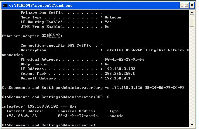

    How does it show if you do "arp -a"?
    Hongmei
  • the result after my operation is shown as :
    I think it's ok. but I don't know why.

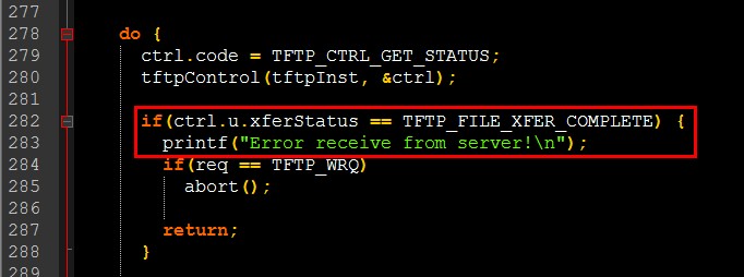

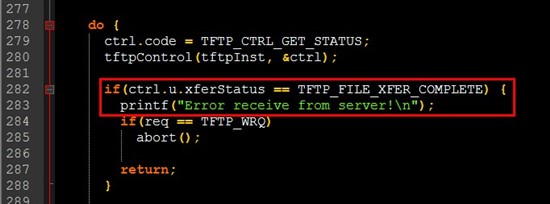

    I tracked the code, find the error place at "siuVctTftp.c":
    Please help me!
    thank you!

  • Hi Lei,
    We tried sv04 (TFTP mode) on a Win 7 PC, and it works fine.
    Please check the following item in your testing:
    1) Is Antivirus/Firewall enabled on your PC? If so, please try with Antivirus/Firewall temporarily disabled.

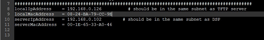

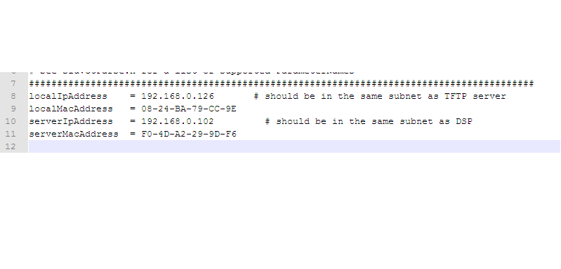

    2) Please check if server IP/MAC in tftp.cfg match with the ones when running "ipconfig /all" on your PC?
    3) Check if DSP IP/MAC is added as one of the ARP entries?

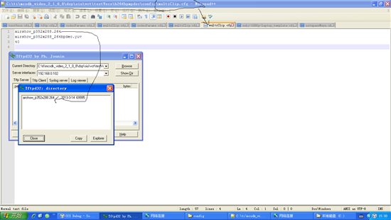

    4) Is the input file located at the "Current Directory" of the TFTP server?
    5) Check the network connection between the EVM and your PC.
    If there is still problem, please use wireshark to capture the packets between DSP and PC. Please send us the cap file, TFTP log, console display of "ipconfig /all", "arp -a" and also your modified dsp\siu\vct\testVecs\tftp.cfg.
    Hongmei
  • the board connect with router, pc also connect with router.
    the step of my lab, as shown:
    1.disable the Antivirus/Firewall on my PC.
    2.set the boot mode as "IBL TFTP boot"
    3.Launch the target configuration and load the GEL file. then connect Target core 0.
    4.load sv04.out
    5.run
    the “ipconfig /all” 、 “arp -s” and "arp -a" shown as :

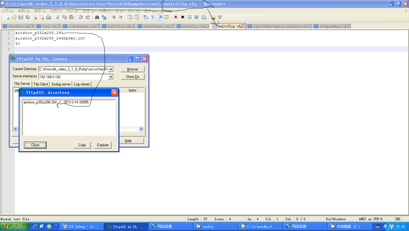

    my modified dsp\siu\vct\testVecs\tftp.cfg:
    this is the TFTP current directory and dsp\siu\vct\testVecs\<codec>\config\multiclip.cfg:
    the wireshark cap as :
