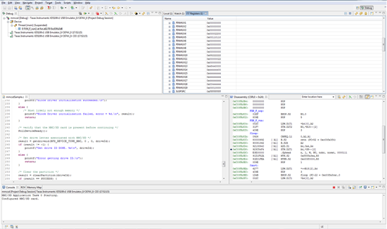

I have been trying to merge BSL based UPP code and RTFS based MMCSD code to collect sample and store data in SD card, respectively for a long time but no success. Both examples are working independently but when I merge them they don't work. I checked the PINMUX for both the project, none of them use PIXMUX5 but when I combine them I noticed PINMUX5 has used which might be a problem but I am not sure.
According to Pix Multiplex Utility, there are PIN overlaps when SPI1 and I2C0 are used together. If this is the problem, how this problem can be solved to merge two projects ? If PIXMUX is not the problem, what other problem it could be or how to solve that ?

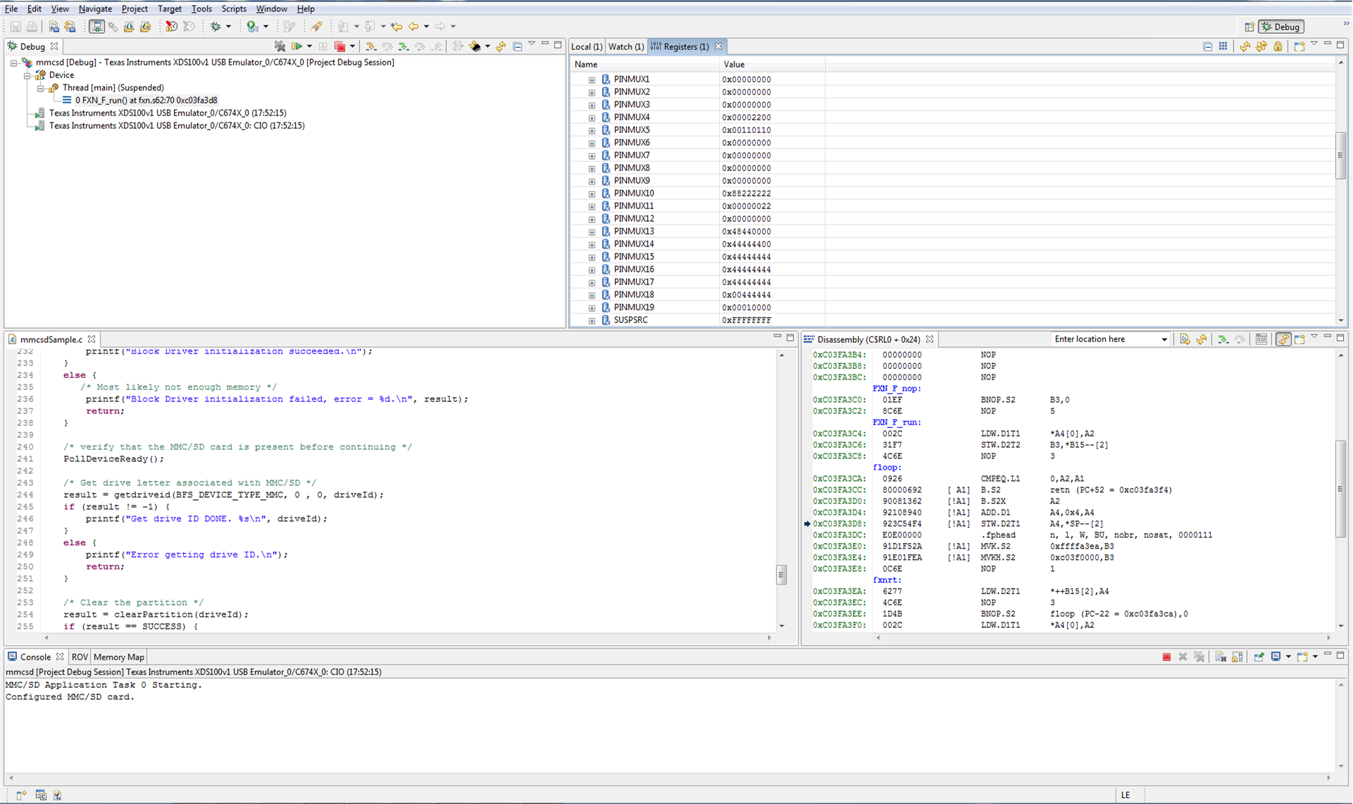

I attach snapshot, you can see that the code doesn't execute further then I halted the processor. PINMUX configurations are also visible.

  • Not quite sure about the SPI1 and I2C pinmux conflict. Some of the upper SPI1 CS lines conflict with I2C. Any reason you can't use one of the lower SPI1 CS lines instead? Have you checked to see if the two projects use the same interrupt numbers?

    While debugging the code, I am unable to see where SPI1 are being active, as soon as it starts executing the EDMA code, I am unable to use breakpoint so I don't know how could I use lower SPI1 CS lines ?

  • From what I can tell from your screen capture, the I2C and SPI1 should not conflict. Assumes that SPI1 uses CS[0].
    PINMUX4 = 0x00002200
    Tri-stated selected instead ofSPI1_SCS[2]
    Tri-stated selected instead ofSPI1_SCS[3]
    Tri-stated selected instead ofSPI1_SCS[4]
    Tri-stated selected instead ofSPI1_SCS[5]
    I2C0_SDA selected instead of SPI1_SCS[6]
    I2C0_SCL selected instead of SPI1_SCS[7]
    PINMUX5 = 0x00110110
    SPI1_SIMO selected
    SPI1_SOMI selected
    Tri-stated selected instead of SPI1_ENA
    SPI1_CLK selected
    SPI1_SCS[0] selected
    TM64P2_IN12 selected instead of SPI1_SCS[1]
    The CS that SPI1 uses in specified in the registers SPIPC0.SCS0FUN[n] SPIDAT1.CSNR[n].
    I doubt that the PINMUX or SPI1 CS settings are the problem. I think you should look deeper in the interrupts. I vaguely remember on the DSP side, there is an IRQ for SPI and I2C. EDMA uses 2 IRQs. I think EDMA has channel allocations that might overlap. Maybe try using non-EDMA code first. I don't have a LogicPD board so I cannot say about the BSL code.
