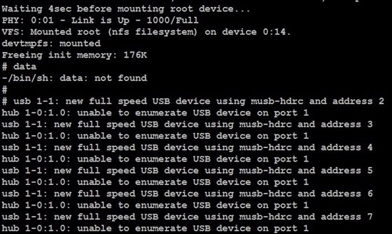

I boot my custom board, but same strange infomation often appear without my any operation:
# usb 1-1: new full speed USB device using musb-hdrc and address 2
hub 1-0:1.0: unable to enumerate USB device on port 1
usb 1-1: new full speed USB device using musb-hdrc and address 3
usb 1-1: new full speed USB device using musb-hdrc and address 4
usb 1-1: new full speed USB device using musb-hdrc and address 5
usb 1-1: new full speed USB device using musb-hdrc and address 6
usb 1-1: new full speed USB device using musb-hdrc and address 7
Who have the same problem? How to solve the poroblem?

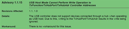

  • did you plug a USB hub?  may I know your DM8168 PG version? it's better if you can provide full boot log
       My custom board add GL850G-28 HUB Controller, and DM8168 is PG1.1.The more log as follows:

    musb-hdrc: kernel must blacklist external hubs

    Waiting 4sec before mounting root device...
    PHY: 0:01 - Link is Up - 1000/Full
    VFS: Mounted root (nfs filesystem) on device 0:14.
    devtmpfs: mounted
    Freeing init memory: 176K
    usb 1-1: new full speed USB device using musb-hdrc and address 8
    usb 1-1: new full speed USB device using musb-hdrc and address 9
    usb 1-1: new full speed USB device using musb-hdrc and address 10
    usb 1-1: new full speed USB device using musb-hdrc and address 11
    usb 1-1: new full speed USB device using musb-hdrc and address 12
    usb 1-1: new full speed USB device using musb-hdrc and address 13
    usb 1-1: new full speed USB device using musb-hdrc and address 14
    usb 1-1: new full speed USB device using musb-hdrc and address 15
    usb 1-1: not running at top speed; connect to a high speed hub
    usb 1-1: New USB device found, idVendor=05e3, idProduct=0608
    usb 1-1: New USB device strings: Mfr=0, Product=1, SerialNumber=0
    usb 1-1: Product: USB2.0 Hub
    hub 1-1:1.0: USB hub found
    hub 1-1:1.0: 4 ports detected
    how to get rid of the printf infomation?

  • According to http://www.ti.com/product/tms320dm8168, you can see following
    the USB hub wasn't supported in 8168 with PG 1.x.
    pls use PG 2.x
