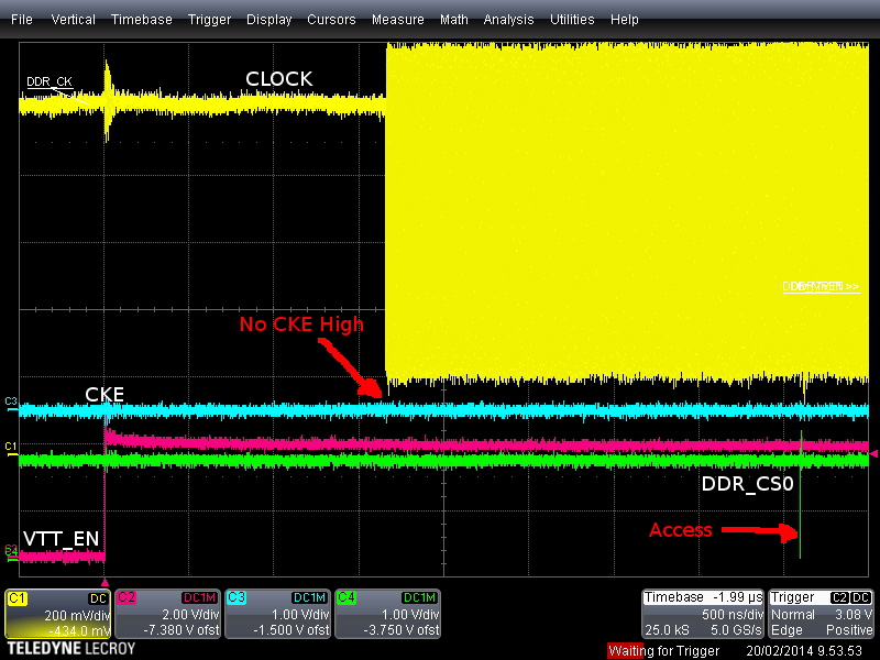

    i have an issue about wakeup form suspend to ram with DDR3 400MHz in my custon board based on AM335x Starter Kit.
    After VTT_EN goes high, NO CKE goes high but the differential clock is present and stable.
    See image

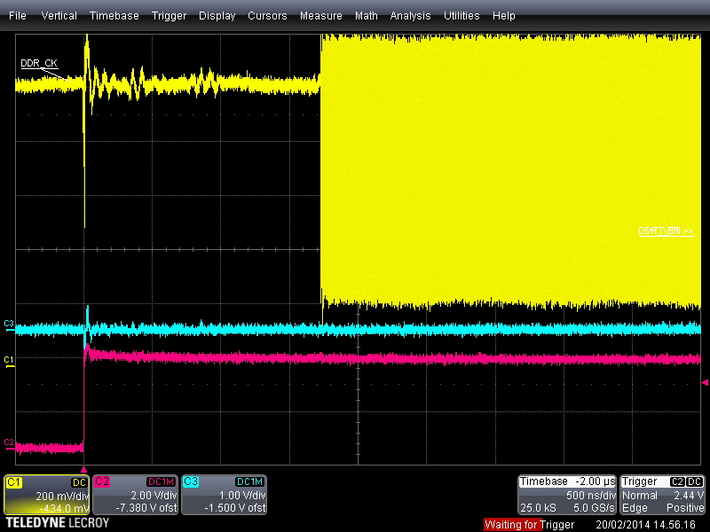

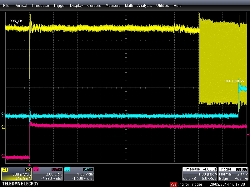

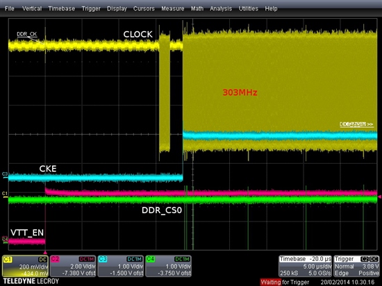

    The same board is working with 303MHz DDR3 configuration.
    A big differece: the time between VTT_EN and CLOCK
    400MHz is every time 1.6us
    303MHZ is variable 10us-200us
    Any ideas ?
    I made a suspend-to-ram on AM335x Starter Kit with
    Linux http://arago-project.org/git/projects/linux-am33x.git?p=projects/linux-am33x.git;a=shortlog;h=refs/heads/v3.2-staging
    Uboot http://arago-project.org/git/projects/u-boot-am33x.git?p=projects/u-boot-am33x.git;a=shortlog;h=refs/heads/master
    but suspend-to-ram with DDR3 400MHz dosen't works: CKE is LOW
