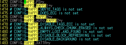

First I patched kernel and u-boot with yaffs2 patch file. then I config kernel configuration to support yaffs2 file system.
Kernel configuration to support yaffs2 is as follows:

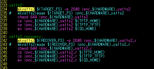

I made yaffs2 root file system image with mkyaffs2 utill in Makefile as follows:

I guess root file system image or writing root file system to mtd block 3 would have some mistake.
