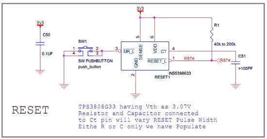

    3. in my hardware cpu reset is available , but its not working . if we give an reset low signal what would the output, how you known that processor has resetteed. Is their any testing methods to test the reset out.or processor will response for reset signal . ?
    Please see the datasheet and the section on Reset to understand the direct signalling effects and the reset effects.

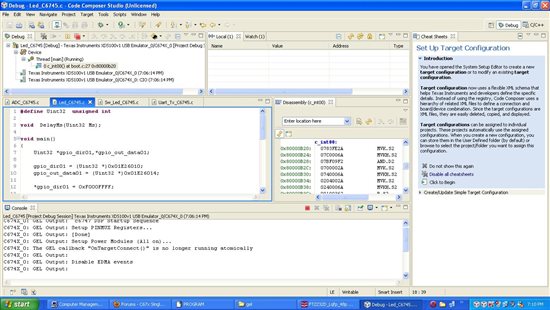

  • RandyP,
                Sir you not answered for fifth question in my previous post about pll.
    Here i attached my error window snapshot image.
    In that PLLCTL  register, PLLEN  always it as bypass mode, if i changed manually to PLL it nos changing. what is the reason ?, at sometimes my gel file running at the end only problem has arising. the following error is running in console window while debug:

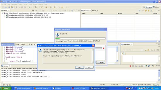

  • Randyp,
               At the same board am getting different error for each trying , the error i received few are listed the below ,
    1. While running gel file it hangs after the enter of PSC on loop, and it showing as error :
    The GEL callback "OnTargetConnect()" for the target "Texas Instruments XDS100v1 USB Emulator_0/C674X_0" is still processing.
    The function could contain an infinite loop.
    Do you wish to pause the processing of this function and continue?
    then i proceed with yes, it enter into debug but  at this i cant able to write even cpu register .

  • Randyp,
                Sir, one of my 6745 custom board reset is always low(1v). At power up reset (RST#) is 3V then gradually it start decreasing to 1v within a second . for what reason the processor will behave like this ?
    For your reference i attached the Reset Schematic here.
    Am expecting the reply..............
    Many Thanks,
    Thiyagarajan.S
  • Thiyagarajan,
    The C6745 will not directly behave like this, or it would never be able to function. The C6745 RESETn pin does not have a huge capacitor with a huge resistor to bleed it to ground.
    Something is causing this behavior other than the normal behavior of the C6745. Do you have an EVM or development board that you can compare the signals with?
    How many boards have you built? Do you have others that show this same behavior?
    RandyP

  • Can you simplify things further?  For example, please temporarily remove the section that does PLL initialization as well as EMIFA/EMIFB initialization.  See if you can run a "blink LED" program from internal memory.
  • Brad,
        i just comment the thing as you said.
    OnTargetConnect( )
        GEL_TextOut( "\nc6747 DSP Startup Sequence\n\n" );
        Setup_Data_Cache();             // Setup L1D to 32 KB cache
        Setup_System_Config( );         // Setup Pin Mux and other system module registers
        //Setup_PLL();                    // Setup PLL0 (300MHz DSP, 133MHz EMIFs)
        Setup_Psc_All_On( );            // Setup All Power Domains
       // Setup_EMIFA();                  // Async EMIF
       // Setup_EMIFB();                  // Setup SDRAM
        GEL_TextOut( "\nStartup Complete.\n\n" );
    when i start debug,  while connecting it start running gel file .
    C674X_0: GEL Output:  c6747 DSP Startup Sequence
    C674X_0: GEL Output: Setup PINMUX Registers...
    C674X_0: GEL Output: [Done]
    C674X_0: GEL Output: PLL Setup Complete
    C674X_0: GEL Output: Setup Power Modules (All on)...
    after this , it keeps on connecting
    after some seconds ,it displaying as follow.
    if i give yes to continue, it look like below image, here i cant able to use run operation. only i can able to do operate halt or terminate all.
    these are the things i got ......
    Waiting for your to debug

  • Comment out Setup_Psc_All_On().  I expect that it should connect cleanly at that point.  Next you'll need to determine which specific modules in Setup_Psc_All_On() are causing you issues.  You'll need to selectively comment out modules to determine which ones are problematic.  I would probably do a binary search just to make things quicker, e.g. try only the first half, then try only the second half, etc.
        Thanks to you both my most of the board was worked , the problem is i got less oscillator  voltage, after tuned then i got 150mv 24mhz . now the processors are working and behaving good. ( This is a Solution point for other engineers who facing same problem).
    my last  six more board i cant able to solve it, i need some ideas from you. these all six boards only problems in 1.2v and reset. Behavior notes for your understand :
    1. two boards 1.2v keep on increasing and oscillating to 1.2v to 1.7v
    2. two boards reset is always low.
    3. two more we have both the problem.
    Kindly help me in this ....................
