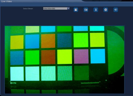

Hardware: APPRO IMX036 IPCAM
Soft:IPNC2.6 OR IPNC3.1

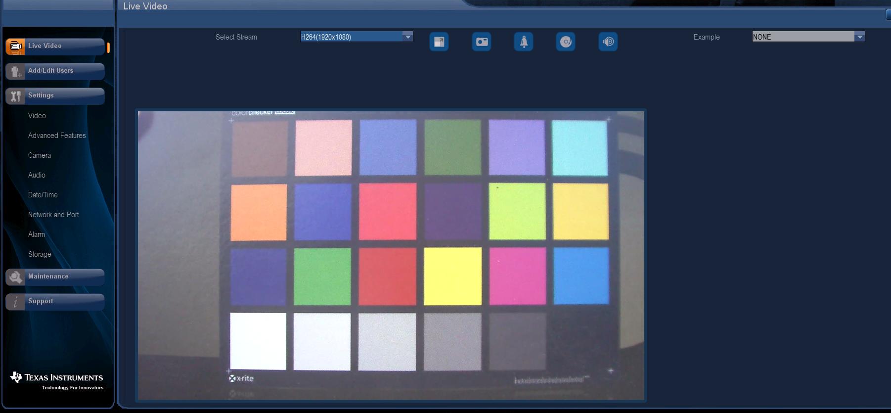

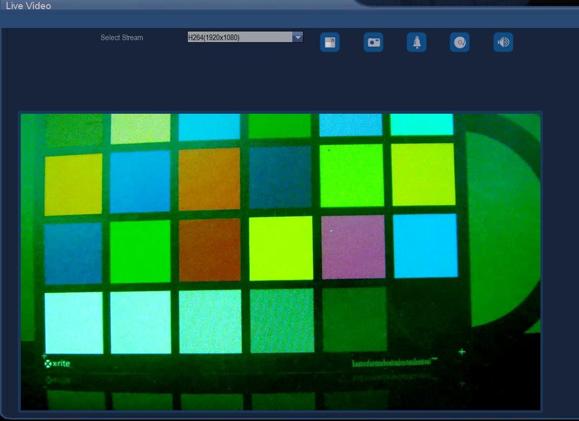

Under the image of the APPRO2A normal, switch to the next TI2A the image is green!
James,
Try to replace : DRV_imgsSetOB(64); // 240(12bits )/4=60 ( 10bits )
with : DRV_imgsSetOB(240),
in : av_capture\framework\drv\usermod\src\imgs_IMX036_3MP\drv_imgs_IMX036_3MP.c
Regards.
