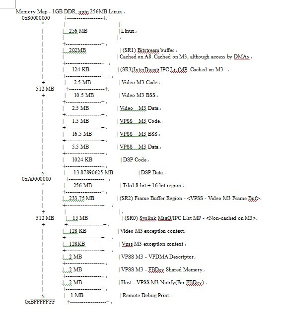

Memory Allocation when build this SDK as fellow:
Memory Map - 2GB DDR

Then I had config DVRRDK_03.50.00.05 to use 1G Memory.
rebuild this SDK and APP
 ./init.sh ./load.sh  ./bin/app.out
Everything is OK. This H264 file is write.
Then printf pBaseAddr = 0x90000080
So somebody Can help me ? what is error?
How can I fix this Problem?
I guess the Memory at 0x80000080 can Access.Because of when we config the SDK to use 1G Memory,The ARM cortex-a8 is use that address.

    [m3video] AAAAAA UTILS: MEM: BITS ALLOC, addr = 0x80000080, size = 7257600 bytes
    [m3vpss ] CAPTURE::HEAPID:0 USED:328
    [m3vpss ] CAPTURE::HEAPID:4 USED:38361600
    [m3vpss ] 135459: CAPTURE: Create Done !!!
    [m3vpss ] 135460: IPC_OUT_M3 : Create in progress !!!
    [m3vpss ] 135460: IPC_OUT_M3 : Create Done !!!
    .....hung up here..

  • Is this the first time you are trying 2G or was it working previously and is now not working with RDK 3.5 ?
    There is something wrong with the uboot as the frequency for the M3 and DSP are showing up wrong.Pls ensure you use uboot from RDK 3.5 . If there are board specific changes to the uboot in your board make sure you merge the changes into uboot of RDK 3.5 and use.
    Check the DMM_LISA settings is set correctly to be able to access 2G.
    Do memtest from uboot to confirm entire 2G memory is accessible.

    3.I had find DMM_LISA_MAP__0 DMM_LISA_MAP__1 DMM_LISA_MAP__3 DMM_LISA_MAP__4 define . But I do not know how to confirm the setting.
    4. I use uboot command md to read mem.(md 80000000 1000) to display mem. Becase of  we has hung up to set mem address at 0x0x80000080.
    Can you help me?
    Thank You very much!
  • Pls first confirm 2G is accessible in your board by first writing to different values to different addresses in the entire 2G range and then reading back the value and confirm it is fine.It is not sufficient to do md <addr>. Even if the EMIF address mapping is completely wrong all addresses will display some valid content.
    Pls share the DM__LISA settings. I can take a look. Pls refer the 816x TRM for detailed info on DMM_LISA.
    I didn't understand what the issue you are seeing with uboot of RDK 3.5 . As I mentioned have you merged in your board specific changes into the uboot ? Have you set the correct environment variables and tried to boot from nfs ?
