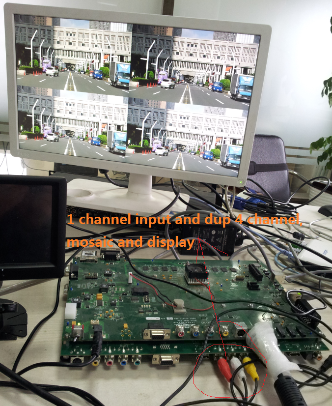

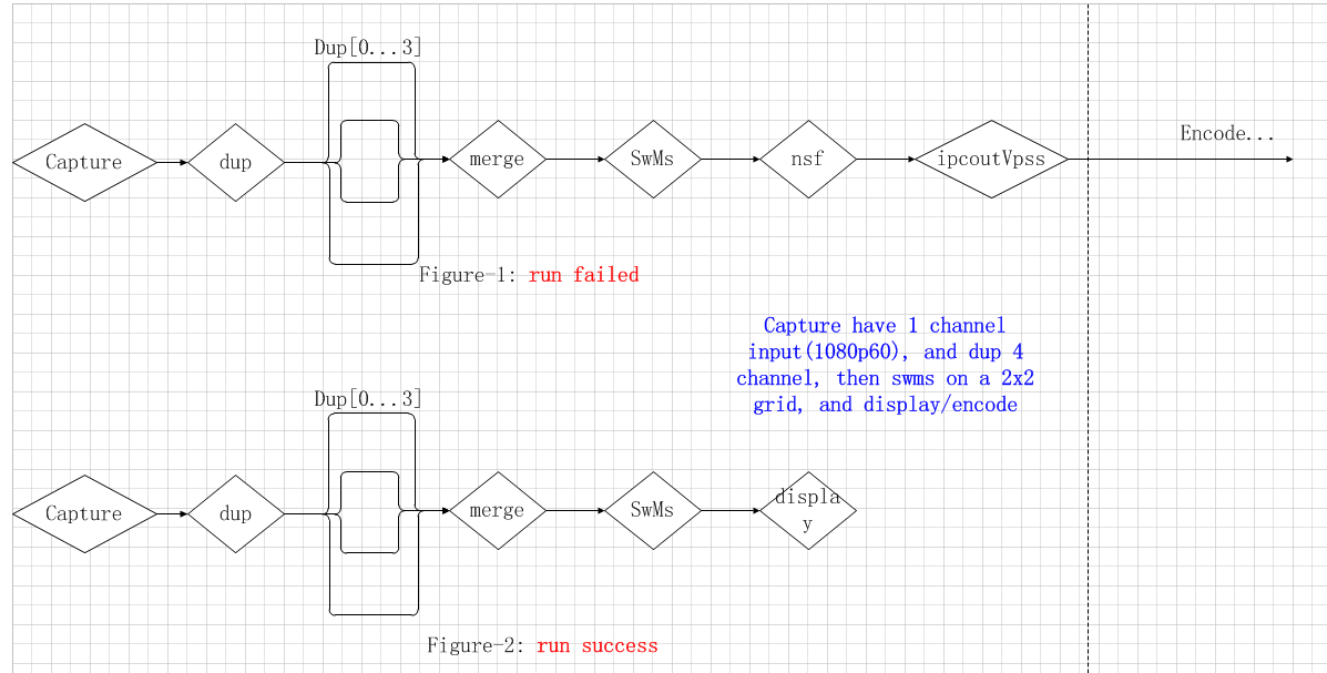

hi, i'm doing the mosaic test, the evm have only 1 channel input,
i'm config it at 1080p60, i  config it  2x2 mosaic(dup 1 channel into 4 channel),
now mosaic and display run success:

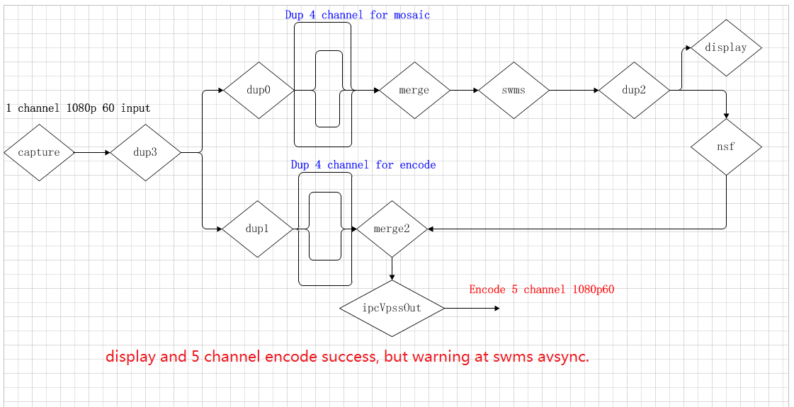

but when mosaic and encode , it failed, i debug the vpss: the swms have input, but not output to nsf,
i think the avsync not config well.
(in 'multich_vcap_vdis.c', if remove define ENABLE_ENCODE_TEST, the display run well.
if add ENABLE_ENCODE_TEST, it change to encode and failed.)

can someone give a idea? thanks.

    =====================2013.3.15=========================
    thanks
  • Set swmsPrm notifyNextLink to TRUE and try. Also put printf in Vcap_start and confirm nsf start is happening
  • hi, Badri, thanks for your reply.
    the swmsPrm has no member 'notifyNextLink'.
    and i add printf every System_linkStart() of Vcap_start(),
    print log is:
    -----------------------------before Vcap_start()----------------------------------
    ---create link ID: 536870946, name: gVcapModuleContext.nsfId[0]
    ---create link ID: 536870919, name: gVcapModuleContext.nullSrcId
    ---create link ID: 536870945, name: gVcapModuleContext.captureId
    -----------------------------after Vcap_start()----------------------------------
    the nsf start is called.
  • Can you comment out call to mulich_progressive_set_avsync_prm in your usecase file
    Also gVdisModuleContext.displayId[0]  = SYSTEM_LINK_ID_DISPLAY_0; // ON CHIP HDMI should not be set if ENABLE_ENCODE_TEST is defined
  • hi, badri, very thanks.
    after remove this line, the console log:

    [m3vpss ] 20733:ERR::linkID:20000036::channelID:-1::errorCode:-3::FileName:links_m3vpss/avsync/avsync_m3vpss.c::linuNum:1227::errorCondition:((avsync_map_linkid2displayid(pObj,cp->syncLinkID) != AVSYNC_INVALID_DISPLAY_ID) || (cp->displayID != AVSYNC_INVALID_DISPLAY_ID))
    [m3vpss ] AVSYNC:WARNING!!!.AVSYNC config invalid for linkID[20000030]:chId[0] Will Default to AVSYNC disabled
    [m3vpss ]
    [m3vpss ] 20734:ERR::linkID:20000036::channelID:-1::errorCode:-3::FileName:links_m3vpss/avsync/avsync_m3vpss.c::linuNum:1227::errorCondition:((avsync_map_linkid2displayid(pObj,cp->syncLinkID) != AVSYNC_INVALID_DISPLAY_ID) || (cp->displayID != AVSYNC_INVALID_DISPLAY_ID))
    [m3vpss ] AVSYNC:WARNING!!!.AVSYNC config invalid for linkID[20000030]:chId[1] Will Default to AVSYNC disabled
    [m3vpss ]
    [m3vpss ] AVSYNC:WARNING!!!.AVSYNC config invalid for linkID[20000030]:chId[2] Will Default to AVSYNC disabled
    [m3vpss ]
    [m3vpss ] AVSYNC:WARNING!!!.AVSYNC config invalid for linkID[20000030]:chId[3] Will Default to AVSYNC disabled
    [m3vpss ]
    [m3vpss ] AVSYNC:WARNING!!!.AVSYNC config invalid for linkID[20000030]:chId[4] Will Default to AVSYNC disabled
  • These warning can be ignored. Have you commented out gVdisModuleContext.displayId[0]  = SYSTEM_LINK_ID_DISPLAY_0 setting as I mentioned.  Also pls share the Vsys_printBufferStatistics after this fix.
  • hi, badri, i'' try it next day and give the result.
    very thanks, best wish.
  • hi, badri, now the 5 channel 1080p60 encode ok(4 channel dup 1080p60, and 1 channel mosaic 1080p60),
    and display 2x2 mosaic also ok, but there is a warning at swms link create:

    i config the avsync for swms, but the warning also exist.
    AvsyncLink_LinkSynchConfigParams avsyncPrms;
    MultiCh_setCustomAvsyncPrm(&avsyncPrms,
    swMsPrm.inQueParams.prevLinkId,
    swMsPrm.inQueParams.prevLinkQueId,
    gVcapModuleContext.capSwMsId);
    the links flow as:
  • You _should_ comment out mulich_progressive_set_avsync_prm  because you don't have a display associated with the avsync. You can ignore the warning at SwMs create time. Warning just says there is no display associated with the avsync which is expected.
