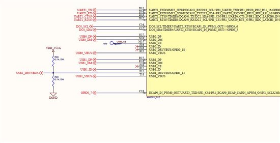

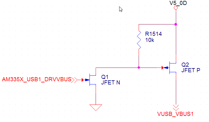

I want to implement USB host ports using a USB Hub on a custom board I am designing using AM3352.  I am using USB2412 and TPS 2052.
I have made almost all the connections for USB2412 as per its eval board and taking reference from Beaglebone.  Now for Host operation, USB_ID pin is grounded. USB_DP and USB_DM from processor are at upstream of usb hub and at downstream ports are two USB A connectors.  VBUS signals for  downstream ports has been provided from TPS2052.
Now the problem that I am facing is how to configure or connect USB_DRVVBUS pin on processor ?? I cannot leave it NC because the schematics checklist that it should be connected to Enable of Power distribution switch. But, that Enable is already controlled by pins from respective downstream ports in USB HUB.  So How do i use USB_DRVVBUS , because it will control the USB_VBUS from processor, which I have used to enable the USB HUB itself.
 Pulling Up USB_DRVVBUS seems to be the only possible solution.  Please help me resolve this problem.

    It would be helpful if you can post the section of your schematics with the connections between the AM335X and the USB2412.
  • Sir,
    I have uploaded the relevant section of the schematics.
  • Hi Nitesh,
    The correct way to connect will be to add a 5V load switch, with power input connected to SYS_5V, power output connected to USB1_VBUS and control signal connected to USB1_DRVVBUS. Please note that USB1_VBUS is not a 5V source, it's a sense input.
    Another possible way to do this would be to drive an open-drain non-inverting buffer with busser input connected to USB1_DRVVBUS, and buffer output connected to USB1_VBUS and open-drain output pull-up resistor to SYS_5V.

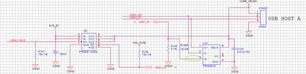

  • Biser Sir,
    I have used TPS2052B  as 5V load switch, whose power input is connected to SYS_5V , power outputs to VBUS of the host connectors and control signal is provided by USB HUB.
    Only thing I am concerned is that if I have made the USB port as Dedicated Host by grounding USB_ID port, do i need to involve USB_DRVVBUS and USB_VBUS on the glue IC side. Please put some light on that.
    I will consider the design with the open-drain non-inverting buffer with my senior though.
    Yes, by all means. The USB OTG peripheral in the AM335X has hardware dependency on these signals. In Host mode USB_DRVVBUS is driven after which a valid USB voltage is expected on the USB_VBUS input. If this isn't observed the USB will not work correctly. There is no software workaround for this requirement.

    It is almost clear that the Enable for the USB HUB is to be controlled by the USB1_DRVVBUS signal which will in turn drive the TPS2052 switch. When TPS2052 switch is on , either of the outputs will generate VBUS signal for the respective host connector. If this VBUS is connected to USB1_VBUS , which is a sensing input, it conveys to the USB controller that the switch is activated and 5V is connected to USB host connector. Now the USB1_DRVVBUS is signal is pulled high when the USB OTG port on the processor acts as host, which we have previously achieved by grounding the ID pin.  I have checked this configuration in alitum, no errors were generated for USB1_VBUS.
    Only doubt is , is USB_DRVVBUS high at 3.3V or any other voltage, because the USB HUB needs 3.3V or higher to be enabled.
    At what voltage is USB_DRVVBUS high by the USB Controller on the processor ?? And connecting multiple VBUSx from TPS2052, as shared in figure in queries above, to USBx_VBUS is fine ??
  • Hi Nitesh,
    USBx_DRVVBUS I/O cells are powered from the VDDSHV6 domain, so active high level will be either 1.8V or 3.3V, depending on the VDDSHV6 power supply.
    As for connecting multiple VBUSx from TPS2052 to USBx_VBUS, I don't think this is a good idea. A better solution will be the one that can be seen on the Starter Kit schematic (http://processors.wiki.ti.com/images/a/a2/TMDSSK3358_3H0009_REV1_2B_SCH.pdf). Please check page 16, component U5B, which is used to signal the processor that VBUS is present. You could design something similar.
  • Biser Sir,
    Why is connecting VBUSx from TPS2052 to USBx_VBUS a bad idea ?? I mean it should be working alright, as far as i can deduce from the circuit.
    The solution that you have suggested, it is using a open drain buffer to generate VBUS signal at 5V from 3.3V PRTPWR signal from the USB HUB. I am already using this PRTPWR pin to enable TPS2052 as this was the suggested way in the evaluation schematics for USB2412 ( USB HUB).  (http://www.smsc.com/index.php?tid=295&pid=245)   .
    Going by your suggestion , I add this extra buffer circuit to PRTPWR1 and PRTPWR2 , apart from connecting to EN1 and EN2 of TPS2052B , to  generate USBx_VBUS similar to the schematics you are refering to.
    You have two USB connectors. How are you going to connect both VBUS rails to one USBx_VBUS input? Direct connection won't do, because it will short the VBUS rails on the two connectors.
  • Sir,
    Thank you sir for bringing that into notice. I did not consider that  condition.
    So you suggest we go ahead with the Open Drain buffer circuit for individual USB1_VBUS from PRT_PWR1 and PRT_PWR2 similar to that in the circuit, along with using PRT_PWR1 and PRT_PWR2 as inputs to enable the TPS2052 at EN1 and EN2 for the VBUSx outputs for the connectors.

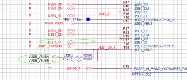

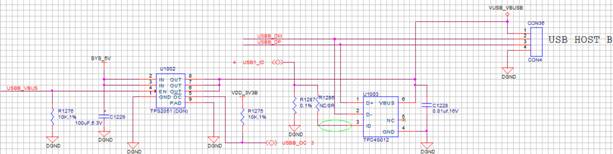

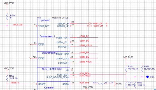

  • HI BISER:
                    My circuit connections between the AM335X and the USB2412 does not work,Please help  me check
  • I don't see how I can help unless you provide more information.
  • HI BIser:My circle was upload as .pdf file too ,please try to download thanks!
     8551.sc-ct-01-1_a1.pdf4643.sc-ct-01-1_a1.pdf
  • Hi Yan,
    Here is what I found:
    • USB0: Replace the 33Ohm resistors R1281 and R1283 with 0Ohms. If you respin the board remove them completely. The USB differential lines should go directly to the USB connector. Only a specialized 90Ohm CMR choke is eventually allowed on these lines.
    • USB1: Tie  processor pin USB1_ID to GND. Remove R1279, place 10kOhm at R1278. Tie USB1_VBUS to SYS_5V through a 1.2kOhm resistor.
    Let me know if this works for you.
  • Additional comments for USB0.
    Add a 1uF capacitor to the USB0_VBUS signal.
    Since the mini USB connector (CON9) does not have a VBUS power source controlled by USB0_DRVVBUS, the port can never operate in host mode.  Therefore, you should make sure the mini USB connector is a mini-B so your customers can not plug in a USB mini-A cable.  Also R1284 should never be installed so USB0 port always operates as peripheral.
    Additional comments for USB1.
    Do not install R1286 and R1287.
    I see you have USB1_ID connected to ground through R146 and R1287 and also an option to connect it to the U10 and U1003.  It is not necessary to connect the USB1_ID terminal to the ESD device or to ground through two resistors.
    Paul

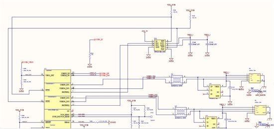

  • Hopefully somebody can help me.
    My schematics are attached. The USB Signals are directly connected to an AM3352. The IOUSBEN Signals are wired to some GPIOs which are pulled high at Boot Time. Before the USB is initialized.
    I added also some 100k Pulldowns to the PWR# Pin to prevent floating issus in combination with the Gate.
    I tested it with a 3.3V Signal at the PWR# Pins. As soon as i give 3.3V to them my TPS Chips are on (Linux GPIOs are set to high).
    The CY6C7.. Chip is set to self Powered mode.5466.SMA_Datenlogger_Rev_1_0_Final.pdf

    I think everything should work if the CY7C.. Chip put the PWR# high when the USB_DRV goes high. But he will not do it.
    Where is my issue?
    I tried also to set the Chip to Bus-Powered mode it didn't help.
  • Felix,
    Again, I am a sw guy and not able to comment on your schematics, but if the USB_DRVVBUS pin or USB_VBUS pin has a 100ms pulse, which means when USB_DRVBUS goes to high to charge USB_VBUS, USB_VBUS rises to slow. USB_VBUS has to reach v4.4 within 100ms when USB_DRVVBUS goes high.
  • Why do you have a 10kOhm pulldown on USB_ID? If you want to use the AM335X in Host mode the USB_ID pin must be tied to GND.
  • 6327.Zeichnung1.pdf
    @ Biser: I already changed the Resistor to 0R.
    i got it to work. But with a really strange hack.
    I marked it with the Yellow Circle in the attached schematic.
    Also it doesn't matter to which PWR# Pin (PWRN1 PWRN2 PWRN3 PWRN4) i connect the 3.3V.
    I also tested it with a 4k2 and a 2k2 Resistor Pullup without R93 -R96. It doesn't work with a resistor between.
    Directly wired to 3.3V it works and Linux enumerates everything.
    I thought it could be a Voltagesource thing. I measured all source Pins from the CY7C65642 and the U10 74LVX08M Chip but all Voltage level are looking fine. Everything is at 3.3V .
    I measured also the Delay between the 5V source is coming uo and the 3.3V source (Not the intern regulated!!) It is a short delay of 20-25 ms.
    Also i desoldered C70 (Reset Pin). To get the response to the USB_DRV Signal faster.
    Could you give me some advise for this strange behaviour?
  • You have the AM335x DRVVBUS signal connected to a delay circuit that holds the Hub in reset until some time after AM335x tries to connect to the hub.  The AM335x device expects to see VBUS turn on shortly after DRVVBUS goes high. The delay inserted by the hub is most likely causing this issue.  When you connect any of the U10 A inputs VCC, the respective port is powered and this feedback goes through the 4-input OR gate that applies 5 volts to the AM335x VBUS terminal.  I cannot explain why a simple pull-up doesn't have the same effect.
    You should reset the hub with the output of a two-input AND with one input connected to a GPIO and the other input connected to your board power-on-reset.  This will reset the hub once power is applied so it is ready to go, but also give software the ability to reset it later if necessary.
    Then use a simple FET circuit like the one shown below to turn on 5 volts to the AM335x VBUS terminal once DRVVBUS goes high.
    I'm not familiar with this hub, but some have an upstream VBUS detect input that may need to be voltage divided down to 3.3 volts from the output of this circuit so the hub knows when the upstream ports is connected.  If so, you may also need to add this connection.
    Paul
  • Finally it worked.
    The capacitor from the Delay circuit was already removed so it should respond faster, but the issue wasn`t solved with this..
    Normal Pullup didn't work cause anything within this circuit drains 40mA, the normal Pullups were to High. But the 40mA makes me a bit nervous. I removed the "Hack" i mean the wire which pulled it to 3.3V.
    So finally I removed the OR-Gate Chip and tied VBUS to +5V.
     Now Linux is enumerating everything correctly.  And after that I patched also the things from Bin Liu into the omap_phy and I hope it isn't only a "lucky shot" that it works now.
    The Hub suspend LED lights short up at boottime when the first 100ms Impuls from USB_DRV comes. Short after that it goes on and stays on and Linux find sthe USB UMTS Modem connected to the Hub.
    USB_DRV is enabling the Hub-Chip how shown.
    Everythin looks fine now (Hopefully it is.. *frightend*).
