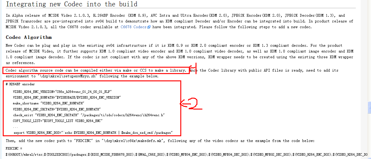

1. I want to add myself codec(AVS) into the mcsdk video framework,  so I reference this web(http://processors.wiki.ti.com/index.php/MCSDK_VIDEO_2.1_CODEC_TEST_FW_User_Guide). There are some problem I don't know how to complete it.
just like the blow:
as shown in the above,
the red "1", I don't know how add my codec code to the existing code, and get the Codec library with public API files.
the red"2", I don't know what the meaning of right hand side.
  can you explain to me and told me how can use "make or CCS to make a library"?

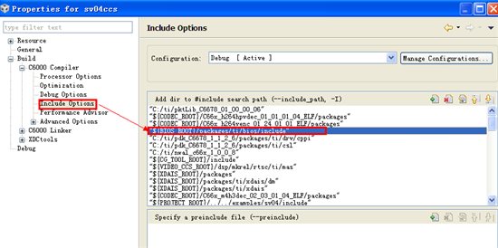

2. I also reference this web(http://e2e.ti.com/support/dsp/c6000_multi-core_dsps/f/639/t/187260.aspx?pi70912=1), Iwant to  EVM6678L do a single channel with AVS encoder and output bitstream via RTP/RTCP. Finally, my goal is AVS encode 1080p at 25fps. I intend to use 8 cores to encoder. first of all, I want to encode CIF in real-time. now, i want to build a project not to use minGw,so I download the 1881.sv04.zip from the above web.but after adding the "build variable" i compile the error. like blow:
example, the "std.h" i have add the path in the "include option",but it's still error. shown as:

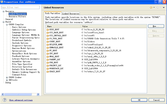

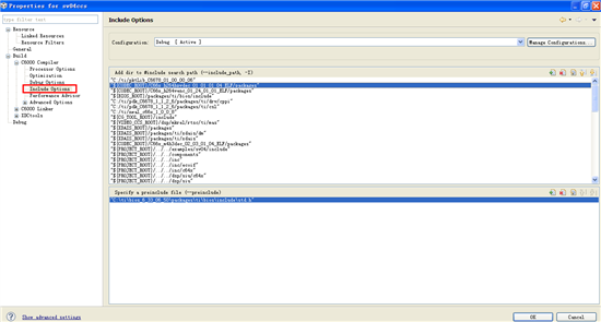

I used ccs 5.2, I have modify the path you have said in the "readme.txt". also i have modify the source code file, example: #include <#include "ti/csl/csl_cacheAux.h" to #include <C:/ti/pdk_C6678_1_1_2_6/packages/ti/csl/csl_cacheAux.h>
so i add the variable in the "linked resource":
 3. if i want to recreate this project what should i do?

    To answer your questions:
    The red "1" "Codec algorithm source code can be compiled either via make or CCS to make a library.":  I don't know how add my codec code to the existing code, and get the Codec library with public API files.
    [Hongmei]: this just indicates that your codec lib should be available and the codec has public API header files for integrating in sv04.
    The red"2", I don't know what the meaning of right hand side.
    [Hongmei]: this is the first step of integrating a new codec in sv04. It sets the environment variables for your codec so that it can be integrated in sv04. For example, if your AVS codec lib is located @ C:/codec/avs_01_00_00_00/lib/avs.lib and header file is @ C:/codec/avs_01_00_00_00/iavs.h, you can add ENV in setupenvMsys.sh as below:
    MYVIDEOBASE="/c/codec"
    VIDEO_AVS_ENC_VERSION="avs_01_00_00_01_ELF"
    VIDEO_AVS_ENC_RUNPATH="$MYVIDEOBASE/$VIDEO_AVS_ENC_VERSION"
    make_shortname "VIDEO_AVS_ENC_RUNPATH"
    VIDEO_AVS_ENC_SRCPATH="$VIDEO_AVS_ENC_RUNPATH"
    check_exist "VIDEO_AVS_ENC_SRCPATH" "/iavs.h"
    COPY_TOOLS_LIST="$COPY_TOOLS_LIST VIDEO_AVS_ENC"
    export VIDEO_AVS_ENC_DOS="`echo $VIDEO_AVS_ENC_RUNPATH | $make_dos_sed_cmd`/packages"
    The above lines sets the ENV for AVS codec,  checks if the codec is available at the location specified, and also exports "VIDEO_AVS_ENC_DOS" which will be later used by make files and linker command file to locate the lib and public header file(s) for the AVS codec.

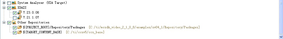

    first of all, I am grateful for your reply patiently. thank you very much.
    I use the CCS5.2/MCSDK_2_01_02_06/MCSDK_Video_2_1_0_8, this is all of my software platform.
    1. my project‘s information

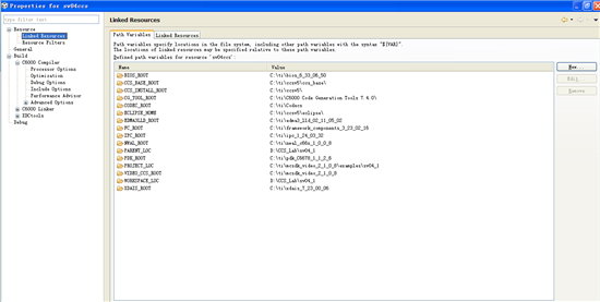

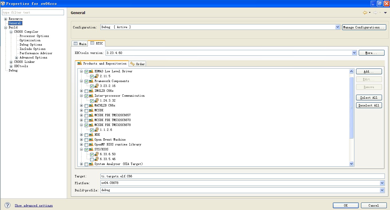

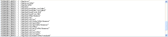

    I have noticed the problem you said. I modified the RTSC shown as below:

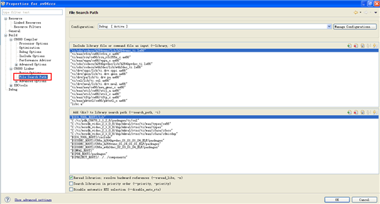

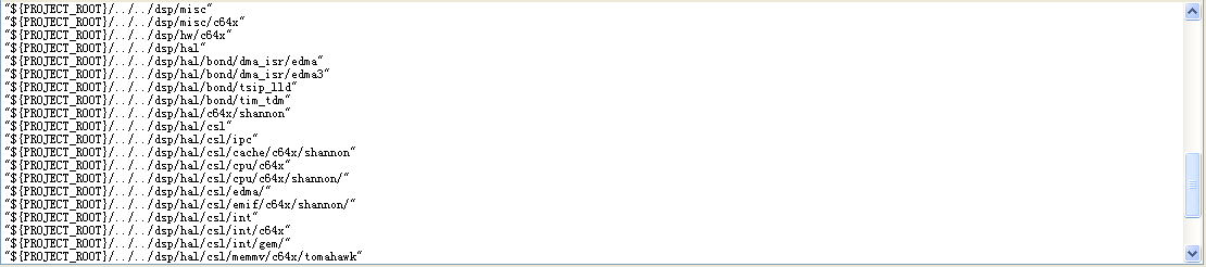

    the configure of project's property shown as following:

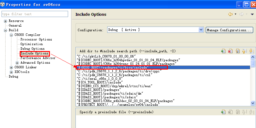

    build include optinon:
    Linker File search Path:
    2. the eventually target:

  • Hi Lei,
    Thanks for all the details.
    As for making CCS project for sv04, your changes look good. However, more changes are needed since some source/header files for sv04 itself have been modified in MCSDK Video. Also please note sv04 builds on C6678 PDK 1.1.2.5 (instead of 1.1.2.6 as shown in your project). We still recommend using MinGW to build sv04 baseline at your first step. Please let us know if there are any issues in building sv04 baseline with MinGW. We can create sv04 CCS project after adding AVS and RTP if you have to use CCS project for your application.

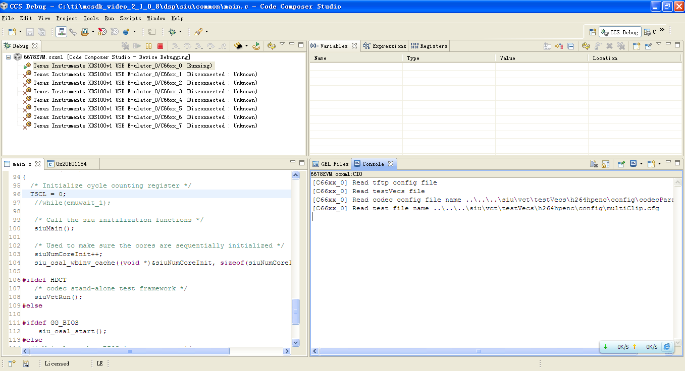

    mcsdk_video_2_1_0_8 contains many codec examples, such as h264bpmpdec, h264hpdec,h264hpenc and so on.
    h264bpmpdec, h264hpdec about these two examples, i have already succeed complete them. but when i do the h264hpenc, there is some problem to come.
     shown as the following:
    there is no error, but also does't go on the application.

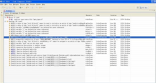

    1. is the "F:\ti\mcsdk_video_2_1_0_8\examples\transcode" example can use for my project?

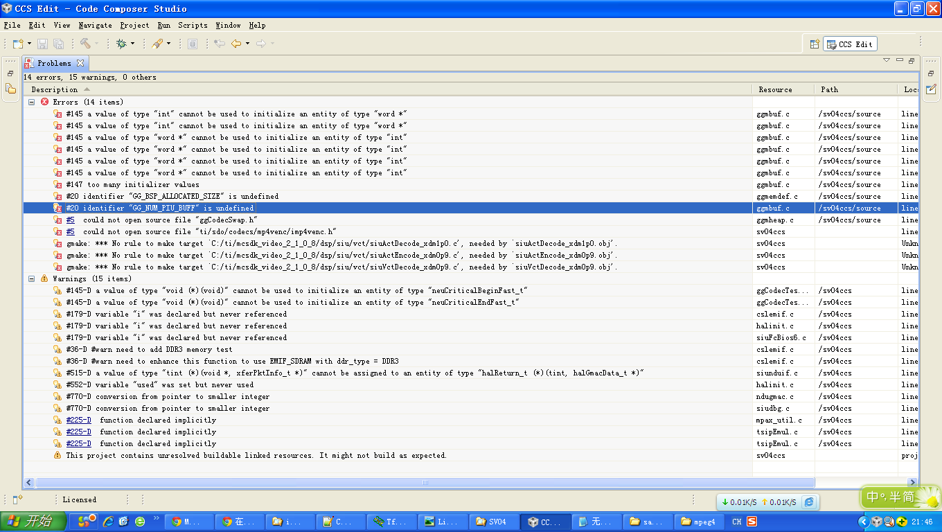

    I compile this project but it reports error. like this:
    how can i eliminate this error?

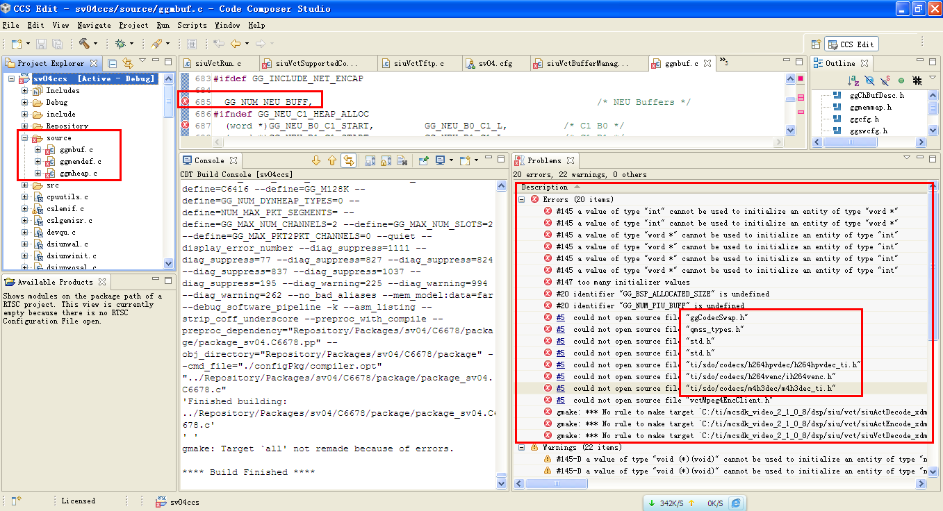

    2.  I rebuild the SV04 which you have up to http://e2e.ti.com/support/dsp/c6000_multi-core_dsps/f/639/t/187260.aspx?pi70912=1. the error shown as below:
    above all, there are two project, but they both reports error.
    the first one is TI provide demo, but it still reports error.
    the second error i cann't find "ggCodecSwap.h" in my PC. To the error of "gmake: *** no rule ...." , i even don't know what it is.

  • Hi Hongmei,
  • Hi Lei,
    As for data transfer via TFTP, please look into files mcsdk_video_2_1_0_8\dsp\siu\vct\src\siuVctTftp.c and mcsdk_video_2_1_0_8\dsp\siu\vct\src\siuVctFileIO.c. Using data input as the example, there are two memcpy involved. The first one is in siuVctTftpGetReceiveIn(), which copies input from TFTP to siuVctFileReadBuffer. The second one is in siuVct_ReadInputData(), which copies data from siuVctFileReadBuffer to codec input data buffer. Both siuVctFileReadBuffer and  the codec input data buffer are in DDR. After that, inside the codec algorithm, EDMA is used to copy data from codec input data buffer (DDR) to local L2. You mentioned that " I should read the data via EDMA to memory". Can you please clarify what you mean by "memory"? Is this something you would like to do inside your codec algorithm? If so, you should be able to use sv04 framework as is.
    Your question 2: "due to Several schools do this project together, we are just responsible for codec. but the sv04's codec interface isn't same with our project needs. so i have to build a flow like what i said above.  whether we can modify sv04 easily. but sv04 is too much code file, i just know some of these, can you tell me which files i can use?"
    [Hongmei] It is easy to modify sv04. Please look into mcsdk_video_2_1_0_8\dsp\siu\vct\siuVctRun.c, in which we have provided codec examples and a memcpy example also. siuVctRunMediaConfigReq() is for network setup and codec create, while siuVctRunMediaProcessReq() is for processing frames (memcpy is just copying the data from input buffer to output buffer). You can plug in your own codec create an process code in the above two functions.

    3.I create a project at the same directory with transcode, then import transcode project, but it reports the error like this:
    in the Include option, i have already add the path.but it still reports this error, can you help me?
    if i modify "ti/csl/csl_cacheAux.h" as "c:ti/pdk_6678_1_1_2_6/packages/ti/csl/csl_cacheAux.h", the error wil disappear. but it will show another wired error.
    what's wrong?
