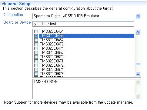

XDS510 USB emulator used for the C6455 development.
CCS5.3 use.
Project to create If you select Device item in the Target Configuration TMS320C6455,
GEL file does not load.
However, the program operates normally, without a GEL file that is over.
Compiled DDR external memory area by setting Heap was operating normally.

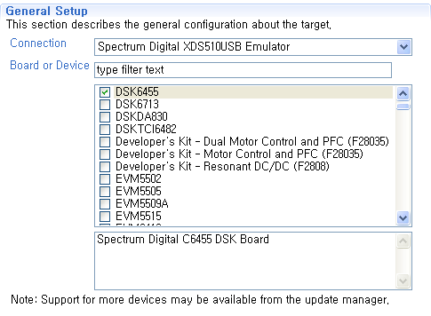

When you select Device item DSK6455, GEL file will be automatically linked.
Device item is selected with the TMS320C6455 and DSK6455 CPU Cycle different results.
TMS320C6455 set to Device item,
GEL has been added to your project file
CPU cycle is the same as the results when you select Device as DSK6455
Whether you select the Device for any item
GEL files are required when you create a project, are not they?

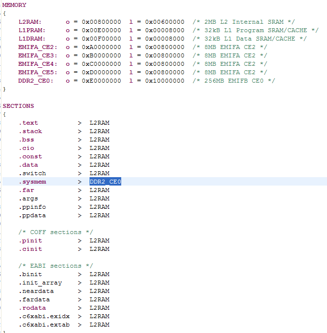

  • Has written a .cmd file as shown below.
    .out file loaded into the DSP,
    to check the source code of the algorithm for the computation time.
    CPU cycle was measured by using the CCS's Run menu - Clock
    You do not have to use the GEL file,
    heap data mapping is performed in the DDR that is difficult to understand.
    .out file loaded into the DSP using the emulator, and test, because
    without using a GEL file,
    heap data has been mapped to the DDR, it is difficult to understand.
    PLL settings, memory initialization were not included in the source code.

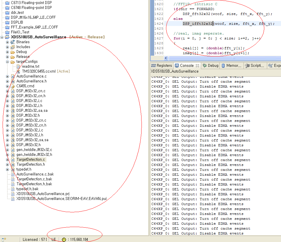

    CPU Cycle measurement results
    Assembly, Intrisic C, Natural C was changed to run FFT function.
    FFT code is shown below.
    Then, using the Run - Clock cycle was measured.
