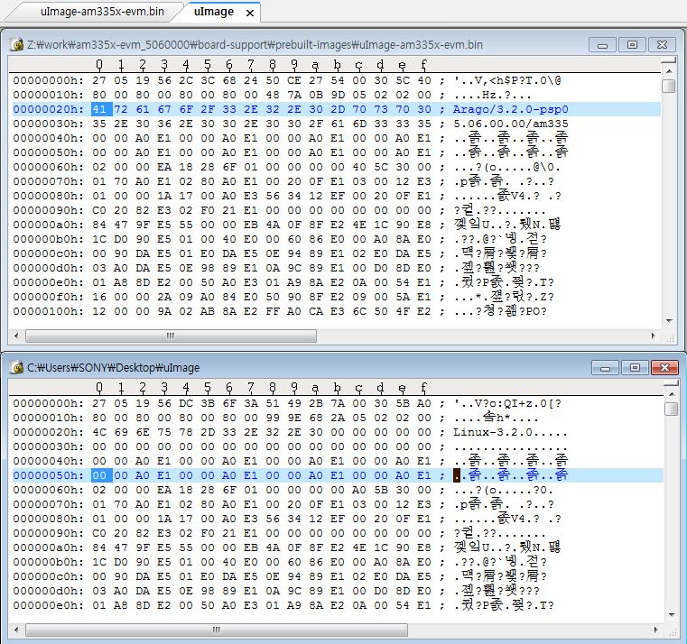

When I open the am335x prebuilt image and compiled uImage the size is slightly different and value also different.
what make it different?
When I check the binary of uImage, it also different. ( prebuilt - Arago/3.2 ...  compiled -  linux3.2..)
Does someone please tell me why?
also when I compile the kernel i can't get the bin image. is it just copy to bin? ( ex)  cp uimage uimage.bin)

    The difference is just in the header section. The uImage is created from the zImage using the mkimage tool. Here is how it is used:
    → mkimage --help
    Usage: mkimage -l image
              -l ==> list image header information
           mkimage [-x] -A arch -O os -T type -C comp -a addr -e ep -n name -d data_file[:data_file...] image
              -A ==> set architecture to 'arch'
              -O ==> set operating system to 'os'
              -T ==> set image type to 'type'
              -C ==> set compression type 'comp'
              -a ==> set load address to 'addr' (hex)
              -e ==> set entry point to 'ep' (hex)
              -n ==> set image name to 'name'
              -d ==> use image data from 'datafile'
              -x ==> set XIP (execute in place)
           mkimage [-D dtc_options] -f fit-image.its fit-image
           mkimage -V ==> print version information and exit
    The argument you pass after "-n" is usually the name and version of the image. Example:
    $ mkimage -A arm -O linux -T kernel -C none -a 0x80008000 -e 0x80008000 -n 'Linux-3.0.31' -d arch/arm/boot/zImage arch/arm/boot/uImage
    This means that most probably the guys from the Arago project prebuilt their image by hand, passing "Arago/3.2.0-psp05.06.00.00/am335" as its name.
    Regarding your second question: the last argument you pass to the mkimage tool is the output filename. It may be whatever you wish. I hope this answers your question.
