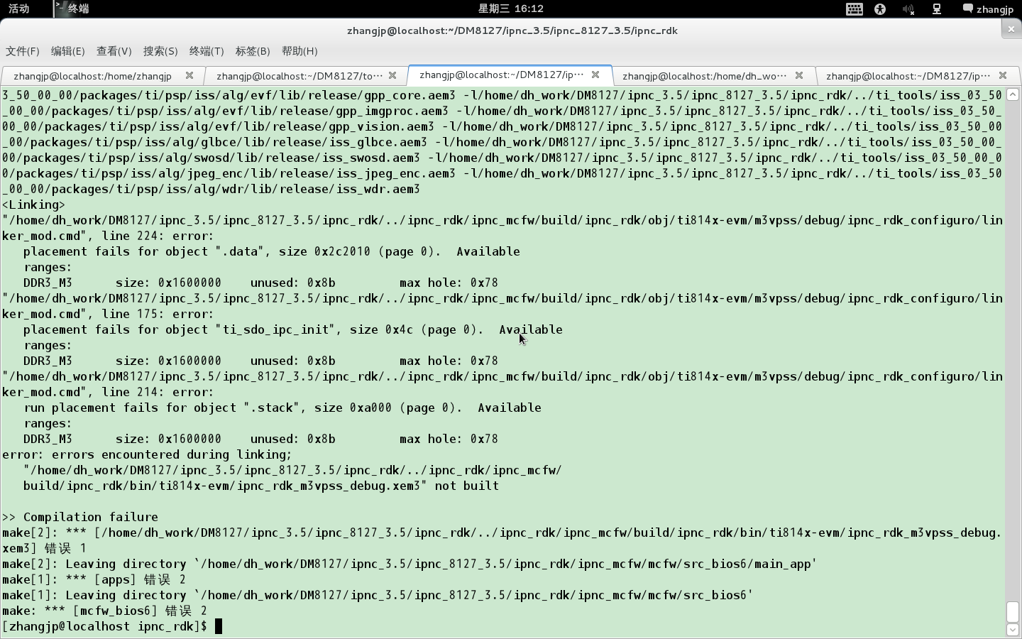

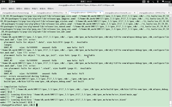

I compile the IPNC 3.5 full feature, it cannot build the debug output. The error is show the following,
Anybody have good idea?

For me, IPNC_RDK_V3.5 builds without any problem.
It appears to be problem with your memmap. You can try to reduce the memory usage in case you tried to increase it .
(Hope you are using 512MB DDR mode not 256MB_DDR).
