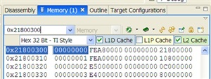

  • Dmytro,
    Could you double check the IB_xxx registers again to see if it is similar as below:
    The IB_BAR 1 (the second row) is used to mapping local L2. In your case, it may look like: 0x00000001 0x82400000, 0x00000000 0x10800000, since the BARn register is assigned by Linux host dynamically.
    And please also check if DDRINIT loaded correctly or not, inside the pcieddrinit_6678.h file (loaded to DSP via PCIE),
    uint8_t ddrInitCode[] = {
    0x10, 0x82, 0xCA, 0xA0, 0x00, 0x00, 0xD2, 0xA0, 0x10, 0x82, 0x00, 0x00, 0x02, 0x04, 0x03, 0xE2, 0x92, 0x46, 0x0C, 0x6E, 0x00, 0x8C, 0xA3, 0x62,
    0x02, 0x28, 0x03, 0xE2, 0x92, 0x46, 0x0C, 0x6E, 0x00, 0x8C, 0xA3, 0x62, 0x02, 0x44, 0x03, 0xE2, 0xE2, 0x40, 0x00, 0x00, 0x92, 0x46, 0x0C, 0x6E,
    0x00, 0x8C, 0xA3, 0x62, 0xDC, 0x45, 0x8C, 0xF7, 0xBC, 0x4D, 0xAC, 0x45, 0x02, 0x81, 0xC0, 0x2A, 0x02, 0x81, 0x04, 0xEA, 0x00, 0x00, 0x20, 0x00,
    0xE1, 0xA0, 0x00, 0x00, 0x02, 0x14, 0x9E, 0x42, 0x6C, 0x6E, 0x10, 0x4D, 0xCC, 0x3D, 0xFC, 0x45, 0x00, 0x00, 0x60, 0x00, 0x02, 0x0C, 0x02, 0x56,
    The yellowed position is the address of the first section, that is: starting at 0x10820000, the data 0x02, 0x04, 0x3, 0xe2 was loaded. Then at next address 0x10820004, 0x92, 0x46, 0x0c , 0x6e was loaded. ….
    You can check them with DSP memory window.

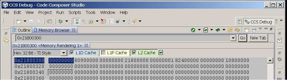

  • Sorry for delay, I checked memory and obtain exact values for IB_XXX as you specified
    Steven Ji said:
    Dmytro,
    My values are:
    As for DDR - now for simplicity I am not touching DDR at all. I use modified example module just for checking
    possibility of configuration and local L2 memory access via io-mem. And such access is impossible.
    Is there any chance that I've got hardware defect on my EVM? And is it possible to exchange the board?
  • The IB registers setup seems fine.
    You may want to check with another PC or another EVM board to see if issue is reproducible.
    Please contact the sales support for the EVM exchange question.
