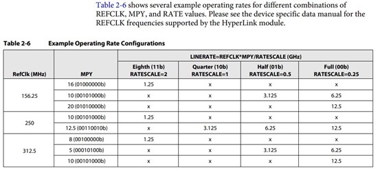

  • In the Hyperlink user guide, Table 2-6, as below,
    When RefClk = 250Mhz, MPY is 10 and Full Rate (ratescale = 0.25),  the Operating rate is x. Does this mean  the above configuration combination
    is not supported ???
  • I believe your SERDES configuration should be fine. normally, performance between DSPs are lower than lntra mode test and trace length and clock, signal quality affect the result. if you are using Molex cable and it is not hard wired, you can not expect max throughput. it will be around half in that case.
    another posibility is what kind of operation you are doing. if you are doig "READ" operation, the total performance will be around half when compared to "WRITE" performance. Read operation consumes more clock cycles for processing.
    Hope this could help.
