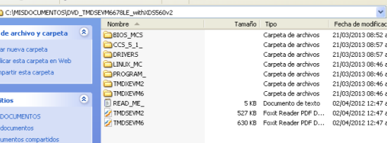

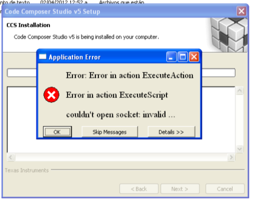

HI, I´m going to work with TMDSEVM6678LE but I didn´t find original DVD, I only find
a copy but it seems to have incomplete names of files, so the installation get error:
Files appear as:
Or in case the download of dvd was not possible could you supply links to software necessary?

  • The major items can be downloaded directly form Advantech http://www.advantech.com/Support/TI-EVM/6678le_download3.aspx
    You can go ahead and download TI's CCSv5 from TI website CCS Download Page.

  • Thanks Chad,
    Here in the office we found the original DVD, but the files are same so the problem is the same.
    I downloaded ccs v5 and installed with the other packages that comes in original DVD and it seems to work but the example

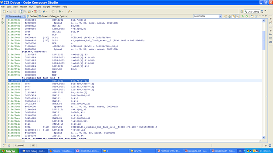

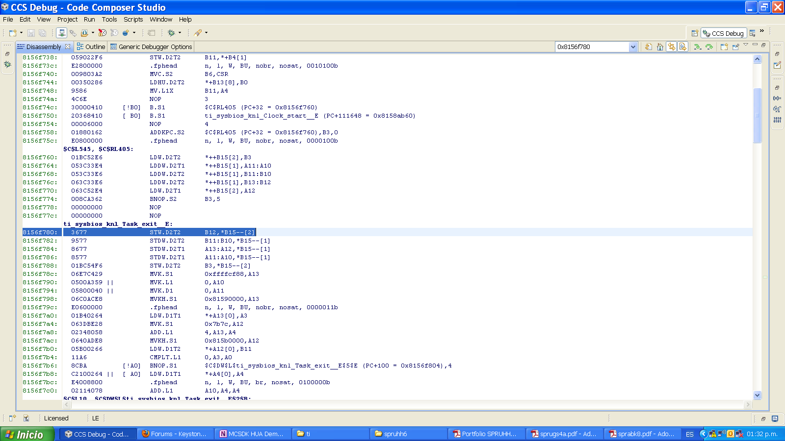

  • Ok, now there's a little more detail.  The IERR = 0x1 that's an Instruction Fetch Error.  PC = 0x0 which is an invalid address.  Looks like the code on CorePac0 is jumping to 0x0 address for some reason. The address at B3 is where it made it's jump to 0x0.  Pull up a dissassembly window at that address and get a screen capture before and after (try to grab 10-15 lines before and at least 5 after in the capture and post it so we can try to see how it managed to jump there.  It could be uninitialized variables being used, corrupted stack, or something else.
    Chad
  • Chad,
    this is the screen capture around the variable you mentioned:
    Julian
  • Well that doesn't make too much sense.  B3 Should be the return pointer from a function call, but that location is at the beginning of a function.  It's not where a function would have branched from.  Maybe the Stack is corrupted,  Can you attach your .map file?  I want to see if B15 (Stack Pointer) has gotten down into other memory space.
