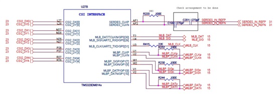

the evm schematic has the CSI interface on page 25; but those pins are RSV6 - RSV14 in the data sheet. does any one know if the CSI interface is exist for DM8148?
thanks,
Bonzai

The data sheet is correct for the DM devices.
Currently CSI2 is not supported in software so references to CSI2 have been removed from the data sheet. CSI2 is supported in hardware.
The schematics are more generic than the data sheet.
